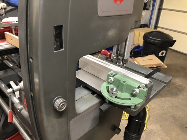

Lol. The ‘Made in Taiwan’ label on the knob may have something to do with the coloring. I will be stripping it down to bare metal. It does have a polished handle clamp, similar to the SS miter gauge.

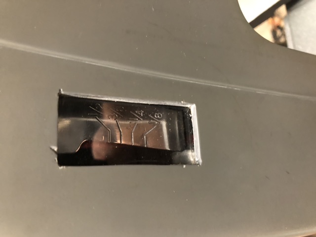

Added a dust control port, the hole to access the tension adjustment and a window to view the tension setting. Any other modifications I should consider before calling this completed?
Re: Bandsaw Overhaul
Foam fill the cubbies that capture sawdust.
BTW why the thumb screws on the brand x miter gauge?

JPG wrote:Foam fill the cubbies that capture sawdust.
The horizontal screws as you know hold the fence on, the two small vertical screws hold the bar stop guide in place (does anyone ever use those) similar to the SS but it uses set screws instead.
I like the foam idea!
I’ve read about a nylon screw upgrade, but so far my vertical adjustment seems solid without it.
Perhaps its time to move on to the belt sanders now...
I have use the stop bar, it worked quite well, but I probably should build a crosscut sled. ;)
I simply have 5/16 flat bottom set screws in those bores and use the always handy SS tool kit for the stop rod. ;)

JPG wrote:Foam fill the cubbies that capture sawdust....
Great idea! What kind of foam do you recommend? I gotta do this mod!
1986 510, jointer, bandsaw, belt sander, scroll saw, jigsaw and lots of accessories. Shopsmith woodworking bench too!
I made a 'cover' using shellacked butcher paper for the bandsaw and the thickness planer. Upon posting that it was suggested to simply foam fill. I have not done so(yet).

For what purpose are the two tapped blind holes in the front miter slot of the cast iron bandsaw table? They are seen in the photo of the OP's bandsaw on page 2 of this thread. I have the same bandsaw and have looked in my manual, but can't seem to find the answer.
