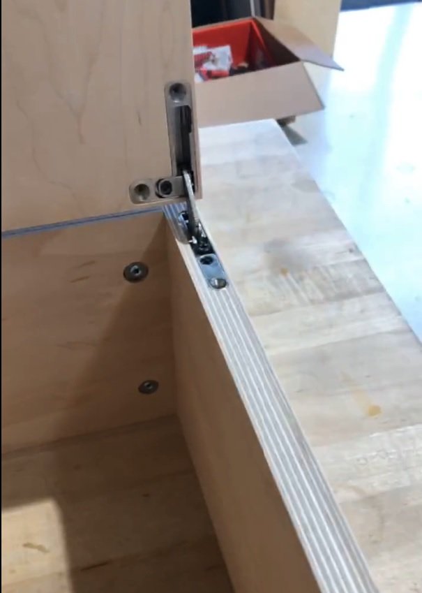

Revising an old thread here...I saw a great video on IG today of an SO in action. I could definitely see the SO and Workstation being very handy for applications like this of creating hinge mortises for specialty hinges. In this video an "L" shaped mortise is needed to install this specialty hinge from Salice. It is a niche application for sure, but one that it does VERY well.
https://www.instagram.com/p/CSZ9q_PqQe5/

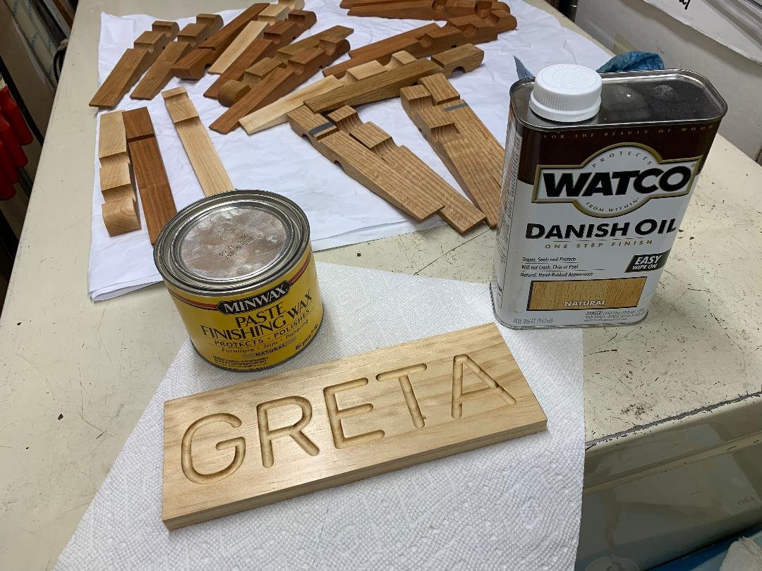

I just finished a sign for our grand cat, Greta.
Now just have to deliver it. I was going to do a cat like drawing but it looked to busy so went with plain. Lost the use of the sketchup plug-in for a couple of days so got behind on project. Belated birthday gift for owner now.
