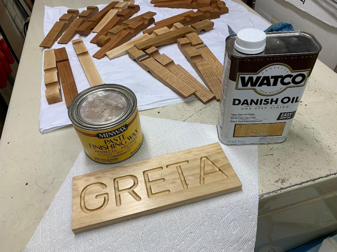

I just finished a sign for our grand cat, Greta.
Now just have to deliver it. I was going to do a cat like drawing but it looked to busy so went with plain. Lost the use of the sketchup plug-in for a couple of days so got behind on project. Belated birthday gift for owner now.
