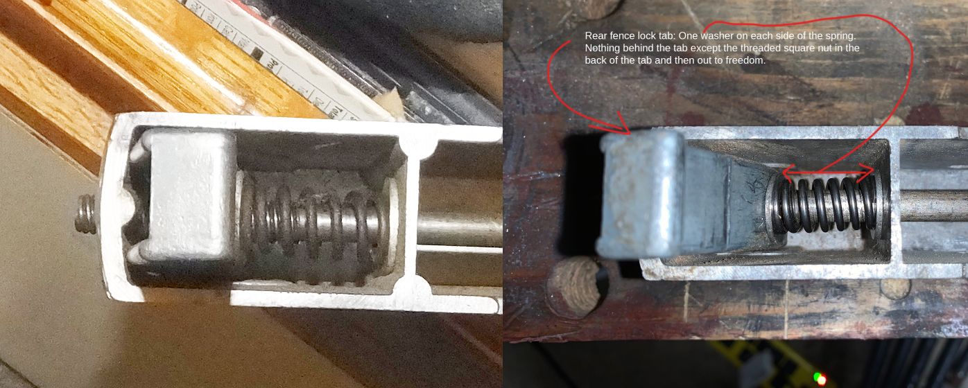

The rear clamp is NOT installed correctly.
both rear.jpg (145.74 KiB) Viewed 12343 times
The left is a properly operating Greenie fence that works correctly on a Greenie table.
The right is sesh's pix.
Note the difference of the rear clamp positioning.(camera angle is NOT a factor).
Notice the raised area on the inside face of the fence.
Note Sesh's is further forward in that area as well as laid back to the rear more.
I think this clearly substantiates the previous conclusion that the rear clamp is NOT pivoting correctly on the pin regardless of why.
Time to push the pin out and remove the clamp for closer inspection.

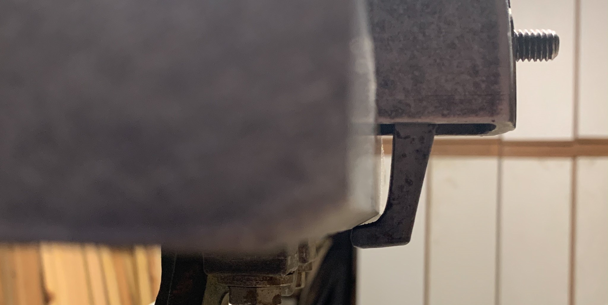

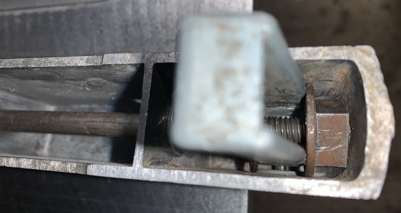

Thanks everybody for chiming in. So, I checked the table and it's perfectly machined to spec at 14 x 18 3/8'ths. Even with modifying the fence base to sit flat against the rail (extending the distance between fence base contact with the front edge of the table to the rear locking tab) I saw minimal improvement i.e. the rear locking tab was still making contact high. The tab made even contact along its width against the rear table edge and it wasn't canted in any direction (canted forward left or right or canted sideways left to right) i.e. it was in a perfect plane to the rear edge of the table. My only speculations were shot down by probability (rear tab cast too thick, holes for rollpin drilled too far forward) I doubt it although, it wouldn't be the first time errors were made in a manufacturing plant. That being said, I made one last modification and that was thinning the contact face of the rear locking tab and because the aluminum casting was thinner, I placed the square nut against a washer outside of the ribs of the rear of the tab (so the nut wouldn't get pulled through the already thin aluminum) and now she makes contact where I want her and locks down perfectly. Will be buying that upgraded fence soon.
Fully locked down
Fully locked down
Thinned locking tab.jpg (261.01 KiB) Viewed 11825 times
Washer before square nut
square nut and washer.jpg (147.78 KiB) Viewed 11825 times
