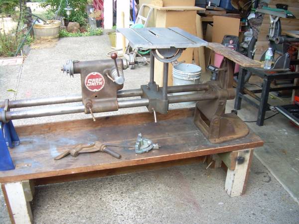

I agree since all the information I have supports those conclusions. My 1947 Model 10E S/N 1077 is on a bench with metal bench ends and retractable casters. It did not come that way originally. It didn't even come that way when I bought it. Model 10's did not come on a bench and it was up to the buyer to make one for it. I call it an upgrade from what it was previously mounted to as I said in the thread on it's restoration. It's been 70 plus or minus a few years since all the Model 10's were made and that has allowed for trading of parts between machines. One incomplete Model 10ER that was given to me was from a guy who was "combining" the best parts of a Model 10E and a 10ER. I don't know the serial number of the 10E but the 10ER is S/N R41856. He had even put the metal extension table on the extension bracket and the tailstock for the wood extension table. See the picture below. What I received is in the foreground plus a few additional parts.
I show this as an example of what swapping of parts adds to the confusion of what version of parts actually goes with what serial number range of the Shopsmith Model 10's. The knob on the wood table bracket and tailstock (background) is the base plate knob used to lock it in the drill press position from the 10ER. It replaced upper threaded stud, washer and wing nut
