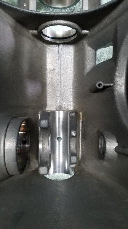

Polished bore.jpg (47.45 KiB) Viewed 9707 times
Update: Finally received the new quill feed assembly and washer!! After many hours of polishing the bore to a mirror finish, the quill now moves smoothly and with even resistance for its entire length of travel. It has good action and feel.
But the quality of Shopsmith parts leaves a little to be desired. The washer came in bag with a label stating that "both washers must be used", yet there was only one washer in the bag. Put a call into Shopsmith about a week ago. Haven't heard back so I went ahead and reassembled with the single washer...seems to work OK. I had to spend about an hour with a thread file cleaning up damaged / badly machined threads before the quill lock handle would thread onto the shaft. Then I discovered that the spring housing is now a press fit into the main housing. And it's a tight one, I had to do a considerable amount of sanding on both the housing and the casting bore to get it to go in at all. The old one slipped in with probably a 64th of clearance, no hammering required.

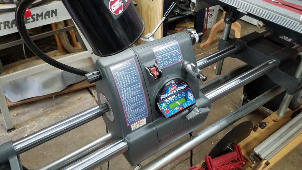

All done! And so far seems to be working better than it ever has. All the locks and the quill seems to have a much better "feel" than before. I am going to run through some tests today to make sure cuts are still coming out square and true.
There are definitely some places where the instructions could be improved.
But here she is all clean and shiny new! I even restored the original production date label.
