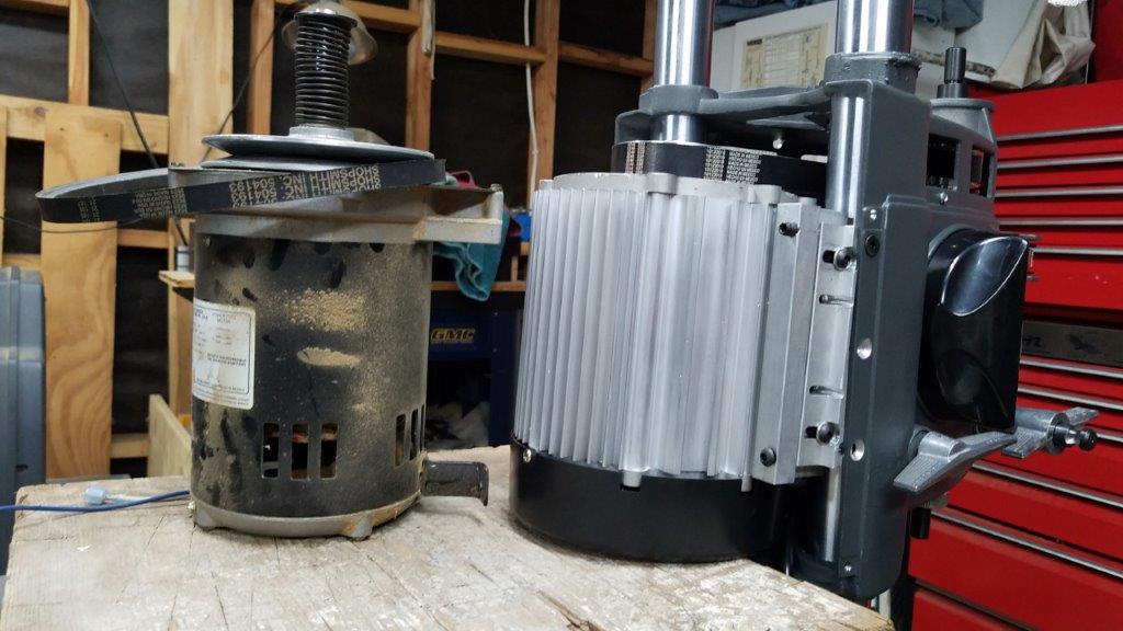

Almost back together! If you haven't seen the new motor for the Pro upgrade the thing is a beast compared to the old motor.
- side by side old motor and new
- both motors.jpg (90.21 KiB) Viewed 9729 times
