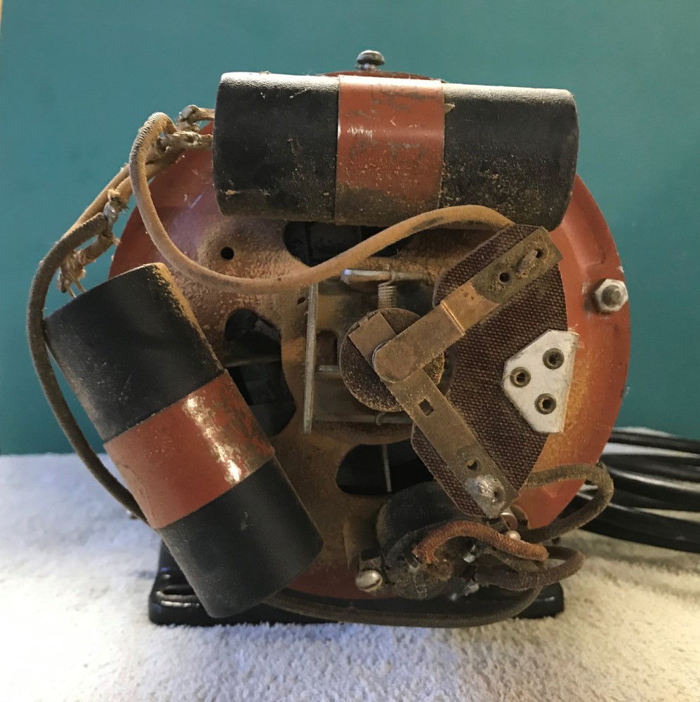

Having the capacitor on the side was another difference on the A. O. Smith 1/2 and 3/4 HP motors made for the Shopsmith Model 10's. I have the A. O. Smith 3/4 HP motors also. In fact I need to finish getting one ready this week, painted and new cords, to put on the 10ER I restored so I can sell it. The wife says I have to many Shopsmiths but she doesn't understand you can never have to many tools. :D
The older A. O. Smith 1/2 HP motors have 2 capacitors under the rear cover along with the contacts. Here it is without the cover.
A O Smith motor end - early r.jpg (183.12 KiB) Viewed 21508 times
It needs some cleaning but does run great. A check of the internal wiring, checking and cleaning the contacts, a paint job and new power cord and she will look and run like new. It turns smooth and easy so I really don't need to change the bearings but I may anyway. As we've agreed these last forever.

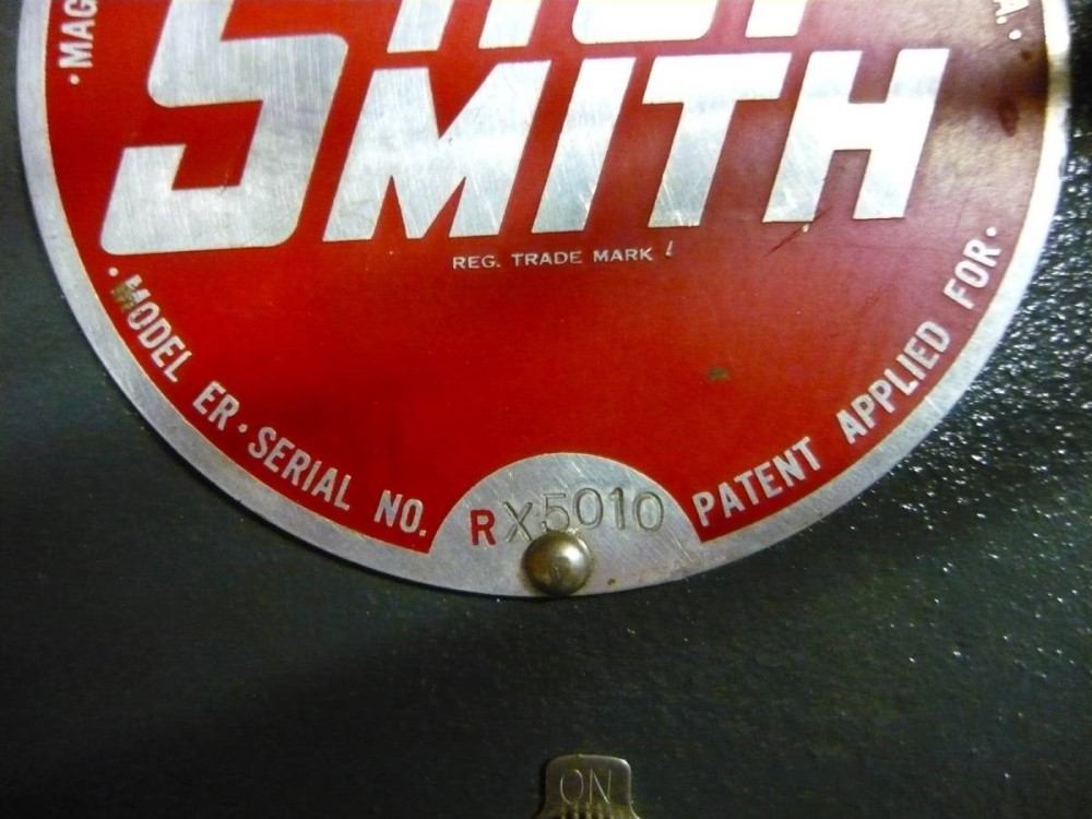

So now I have seen a Shopsmith Model 10ER that confuses me. It was for sale on craigslist a little over an hour and a half from me. Below is a picture of its Logo/Serial Number Plate.
10ER RX5010.jpg (137.6 KiB) Viewed 21479 times
The Serial Number is RX5010. The X is the confusing part of the serial number. This is the only one I have seen in looking at more than 370 Logo/Serial Number Plates of Model 10’s that has an X in the serial number and this one having the X replacing the tens of thousands number.
This one is an early 10ER with the Large Base, 4 Bolt Headrest, Early Blade Guard and one of the last two versions of the Headstock to use double wedge locks. Looking at the Headstock it could be either version 4 or 5. The pictures do not show the spring housing well enough to be sure but I think it is a version 4. It has parts that don't match up to groups of Model 10's made. Judging by the Headstock the X could be replaced in the serial number as a 3, 4 or 5. The Large Base and 4 Bolt Headrest would be more like a 3 or 4 for the X. The Blade Guard would have it in the 2 or lower range for the X. Now this is a restored Shopsmith Model 10ER. It is possible that some parts have been replaced with parts from different Model 10s of different vintages. That would explain mismatched parts. It doesn’t explain the X in the serial number though.
I would think it could have been a Demo unit but it doesn't have a logo plate on the back side of the headstock. John has or had a Demo unit but the serial number was a normal one if I recall correctly. I know John will let us know if I am wrong.
I have already been asked if it could be an Australian Model 10ER but of the ones I have seen any information on, doesn’t fit this one. The Australian ones I have seen, which are not many, are later Model 10ER's. Small Base and 2 bolt Headrest among other later parts. Their serial numbers have an “A” prefix or no prefix at all.

A final thought. One thing I noticed about the serial number and question is the size and placement of the X and numbers. They look a little larger than the preprinted R and they appear individually stamped. They are not lined up as all other serial numbers I have seen on plates. Unfortunately, I was not able to talk to the seller and it has sold so no contact information is available. I wonder if he had a blank Logo/serial number Plate, maybe from the back side of a demo unit, and made up this plate.

[quote="chapmanruss"]So now I have seen a Shopsmith Model 10ER that confuses me. It was for sale on craigslist a little over an hour and a half from me. Below is a picture of its Logo/Serial Number Plate.
$matches[2]The Serial Number is RX5010. The X is the confusing part of the serial number. This is the only one I have seen in looking at more than 370 Logo/Serial Number Plates of Model 10’s that has an X in the serial number and this one having the X replacing the tens of thousands number.

A final thought. One thing I noticed about the serial number and question is the size and placement of the X and numbers. They look a little larger than the preprinted R and they appear individually stamped. They are not lined up as all other serial numbers I have seen on plates. Unfortunately, I was not able to talk to the seller and it has sold so no contact information is available. I wonder if he had a blank Logo/serial number Plate, maybe from the back side of a demo unit, and made up this plate.[/quote]
Wow, that is strange. Yes mine has a conventional data plate, SN 69356. The difference with mine is that the logo on the back side of the head stock is not a data plate. It is a decal or painted on.
If he had a blank data plate it must have come from that machine. If so there should be attachment holes on the back side of the head stock.

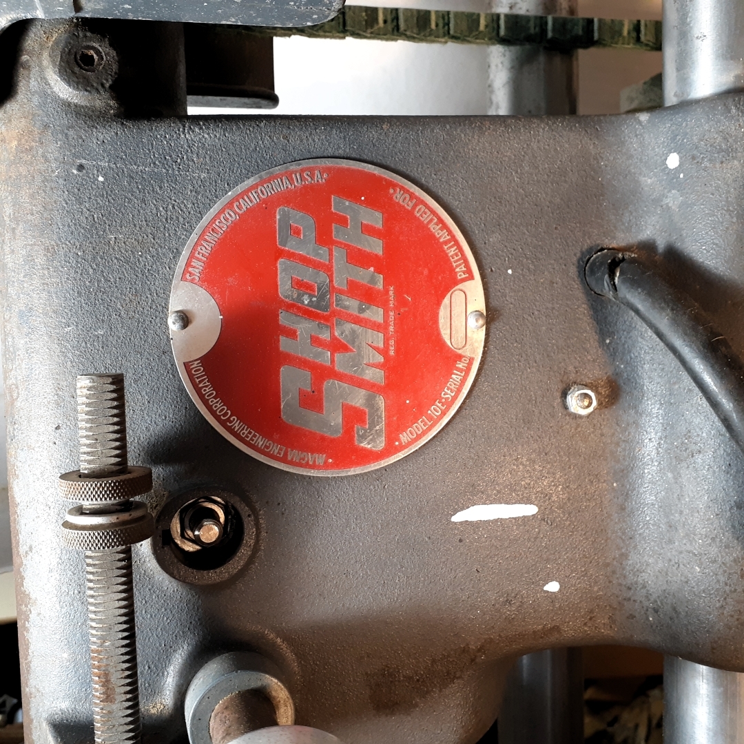

Russ, it is one of mine that has the blank logo plate on the back.
back plate.jpg (906.77 KiB) Viewed 21445 times

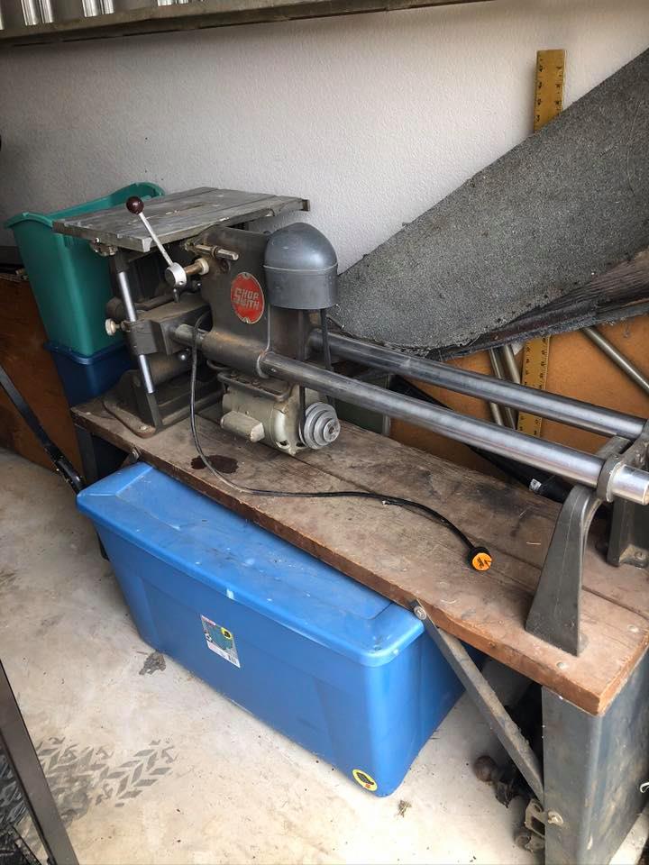

Oddly enough, I was looking on Facebook Marketplace just yesterday and spotted this one in Texas.
https://www.facebook.com/marketplace/it ... ct_details
texas demo plate.jpg (94.53 KiB) Viewed 21445 times

Thanks for the input. Looking at Ron's and the one for sale in Texas it could be possible for that seller to have taken the blank Logo/Serial Number Plate off an earlier Model 10. John's shows that later demo units had the painted on logo. This seller may have replaced the original plate on the one he restored or maybe it's original plate was missing. Pictures of the back of the headstock do not show holes for a logo plate to have been attached on it. The holes may have been there but covered up before it was painted or it could be from another headstock. We may never know how X5010 came to be that way.

The Texas unit appears to be a similar vintage to mine (double wedge locks), so is likely a part of the same run. There was a member on the old Yahoo group that also had one with the extra plate on the back and his serial number was very close to mine (less than ten difference)
Regarding the X serial number, I wonder if it might have been set aside for use on the production line and that is a date code. ie October 1950. Just a WAG.

I tried to contact the seller but was unable to talk to them so as I last said we may never know how X5010 came to be that way.
