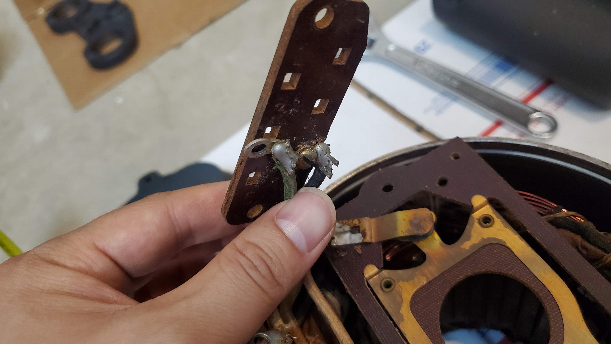

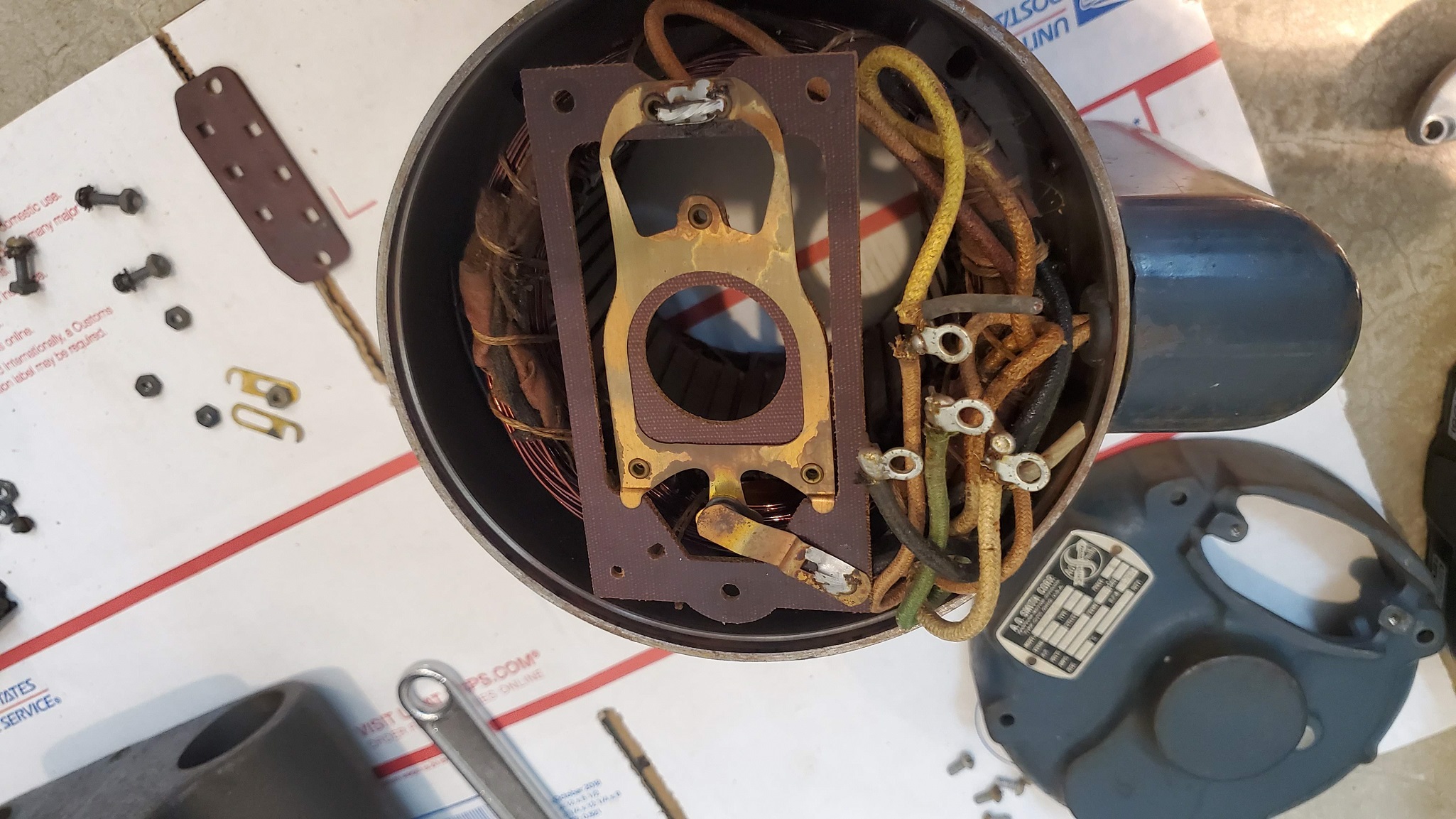

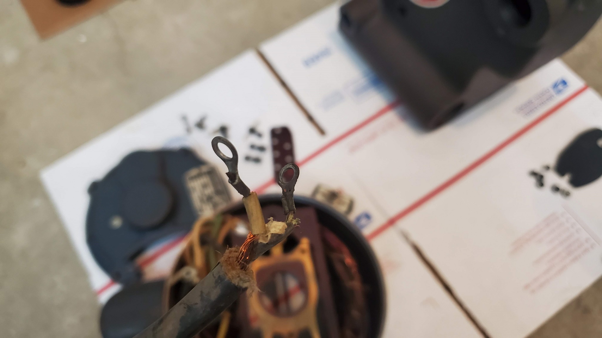

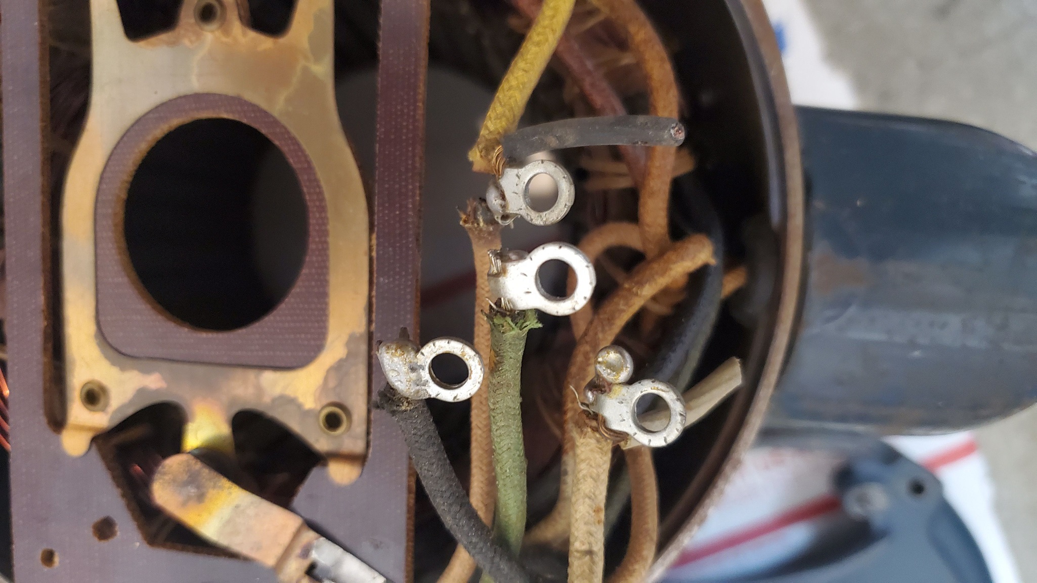

Update -
Took a closer look at the motor and noticed the cord differently needs to be replaced (making a cracking sound when I bend it). Glad I didn't test it before checking everything.
While removing the old cord, I noticed the soldering looked a little messy. I'm not an expert, but have rebuilt enough vintage audio equipment to know the difference. Does this look factory? or think some work was done to the motor?
