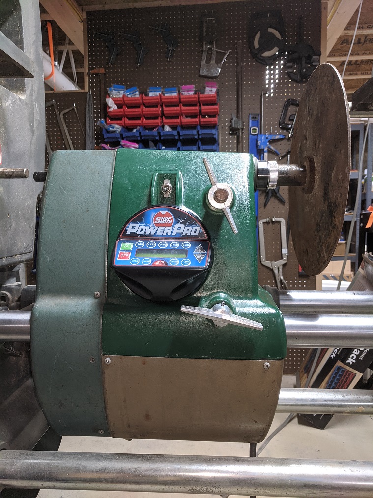

Re: I'm doing a Power Pro Self Upgrade
Pic of the Power Pro headstock.
- powerpro.jpg (347.67 KiB) Viewed 10380 times
