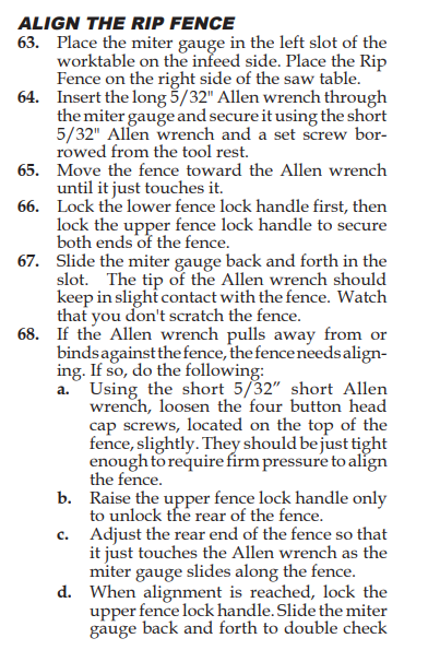

DLB wrote:Paraphrasing the manual: With the infeed clamp locked and the outfeed unlocked, "they (screws) should be just tight enough to require firm pressure to align the fence." Square the fence, then lock the outfeed clamp to hold it while tightening the four screws. Double check your alignment.

I was looking for the Mark V 520 Upgrade Package 555771 but was not successful. However, I found the same words relative to the rip fence alignment in a document titled Shopsmith Mark 7 Home Workshop System.
Here is an extract from that manual:
%20 Rip Fence Alignment.PNG (106.7 KiB) Viewed 4748 times
