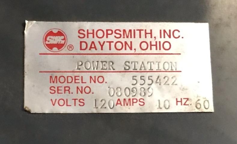

Been working on getting that headstock into the stand I have for the Delta Bandsaw, but then today I found a Power Station in very good condition, with nice clean casters too. The 3/4 HP motor is plenty for the bandsaw. The bandsaw shaft will be slightly higher than the Power Station shaft, but the whole speed control box on the Power Station can be raised up to match. It would be interesting to try to mount the bandsaw using the short tubes on the Power Station but I'm not sure that would work well and I'll probably mount it on some sort of custom carriage plate.

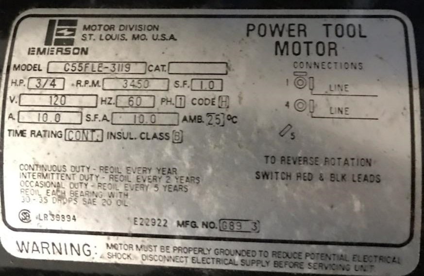

Interestingly, according to the motor nameplate it would be easy to add a switch to reverse that motor if someone needed that capability.

- power station serial number.jpg (52.35 KiB) Viewed 1544 times
