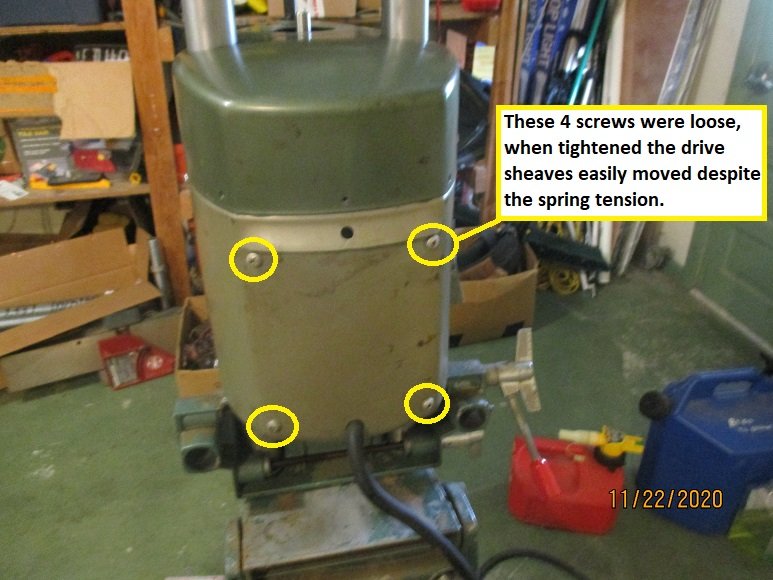

Problem solved! :D I found the four screws that secure the motor were loose. When I tightened the four screws, I was able to manually open the drive sheaves. I now have a fully rebuilt and operational "hybrid Greenie". :D

Is it high spring tension, or, weak fingers pulling it out? Yes that is a very stiff spring.
Above posted before reading the last post above.
Not sure I understand WHY loose screws would cause binding unless that caused the floating sheave to get cocked on the shaft.

Like JPG, I can't explain why that was the problem but glad you were able to resolve it.

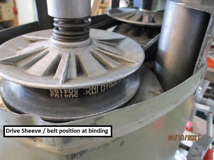

The Greenie has been working well until today. While operating in the table saw configuration the motor bound up and tripped the circuit breaker.
Upon investigation, I found the motor drive belt was the culprit. Aparently it bound up in the drive sheeve enough to cause enough load on the motor to trip the circuit breaker.
The drive sheeve slides easily during manual activation. I'm at a loss why the drive belt bound up?
Do any of you have any simular experience and a fix for the problem?
Thank you in advance!

Is the motor belt less than 1/2" wide at the top?
When set to "FAST"(max speed) where is the belt riding on the motor pulley?(how far in from the periphery)(od).

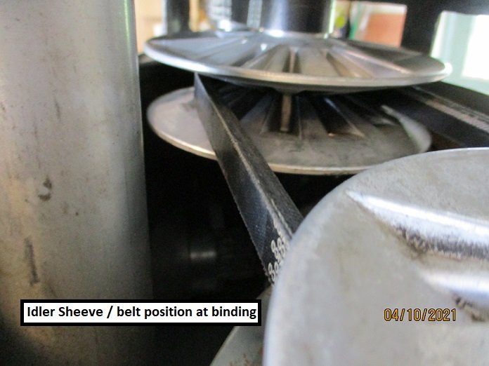

The motor (drive) belt looks to be seated at the inner portion of the sheeve when the binding occurs. (see photo)
Still working on adjusting the spped to fast. Currently the motor is bound up and unable to move. :confused:

I was suspicious that the belt was jammed in the pulley.(caused by too narrow a belt or incorrect high speed limit )
Clearly it is not jammed. The belt appears close to new.
Did you say the floating sheave moves freely in/out on the motor shaft when moving the sheave by hand?
Is the 'motor' bound up or is it the pulley.
Something not obvious is going on here.

I think the problem is in the speed control as it is very difficult to operate even eith the drive belt removed. :mad:

AND is it still 'stiff' with the control sheave also disconnected from the porkchop?
However this does not explain tripped CB.
I think we have a moving target.
