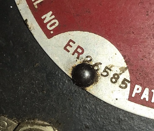

Now I have 10ER #26585. It's in ok shape but needs more cleaning than the other one. It was already listed in the survey, not sure who Gregg Jones, could be the guy I bought it from, but I hardly remember that, it was at least 8 years ago. I'll sort through all the parts and post some pictures eventually, but I think this will sit until #58528 is restored, and that's not at the top of the list either.
- 10ER 26585 nameplate.jpg (122.98 KiB) Viewed 3283 times
- 10ER survey 26585.jpg (14.49 KiB) Viewed 3283 times

It is important to note that you have Serial Number ER26585 not just 26585 and it was made in the eastern plant. Somewhere out there is S/N R26585 and is a 10E made in the western plant before yours. The R was added to the western plant serial numbers beginning around the time 26585 was made there.
