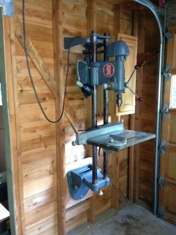

I'm sure John will answer it but his Drill Press Model 10ER is mounted on Shopsmith Bench Ends with shorter boards. I have seen one mounted to a wall but given the choice I would prefer the set up like John's.
Drill Press.jpg (35.61 KiB) Viewed 901 times
