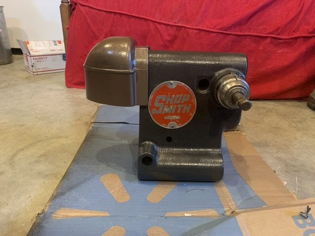

Re: Another 10ER Restoration
Coming along.
- 9D04A3D8-53A8-48CA-B0C5-9F0D291A2FF8.jpeg (91.57 KiB) Viewed 1196 times
The rustoleum hammered black is within shouting distance of the original color, to my eye.

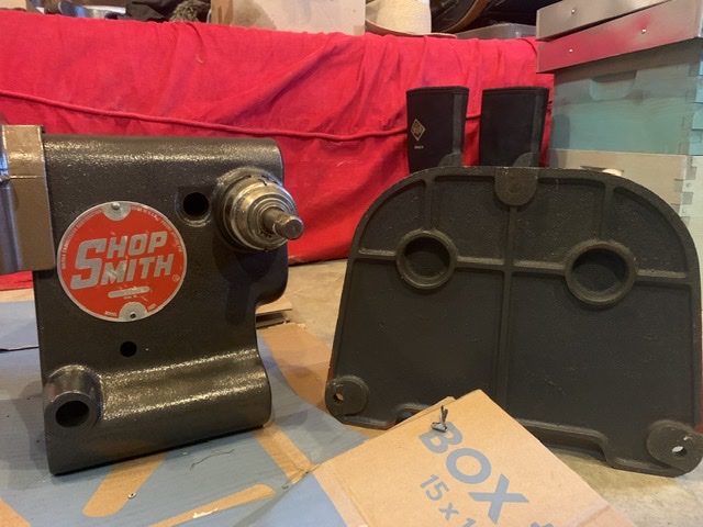

Original on the right. I decided to not paint the unfaded bottom of the base, to keep some original paint for posterity, future color matching, etc.
Whoops, here it is.
- 6B86CEF8-071F-4C2D-96BA-2A6FC00DF5DA.jpeg (95.15 KiB) Viewed 1195 times
