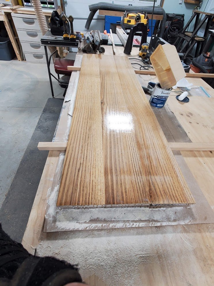

Hey again Guys, Well yesterday I did have a chance to work on the table top. It is now all set to install onto my dads cart. It had been ran through my 24" drum sander with 80 grit and 120 grit paper init, then sanded with 150. I then applied 2 coats of semi gloss poly and sanded it again with 220 and applied 2 more coats. Then sanded again with 220 and applied one last coat of poly. This top is so slick a fly will have trouble landing onto it. Next up is to strip the paint of the angle iron trim he had wrapping the table top he had on it and then painting it. Maybe then I will sand and paint the cart itself. More pictures later. Thanks guys.

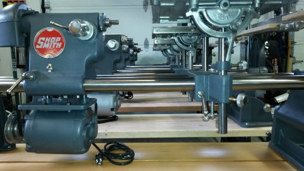

It continues to look better and better everyday.
After several tries on my first restoration I settled on Rust-oleum Charcoal Gray with a matte clear coat finish. I found it to be the closest to the original color of the painted parts like the Miter and upper Saw Blade Guard. I use the Matte Clear Coat to dull the finish to make the cast iron parts look closer to original. I don't recall trying the paint you are using. On some of the A. O. Smith motors I have used Satin Nickel color from the same Metallic paint line as you are using. Of the motors I have gotten on the Model 10's some were originally silver while most were gray.
4708-8865-55582-R57376-R64000 thru.jpg (108.41 KiB) Viewed 1665 times
