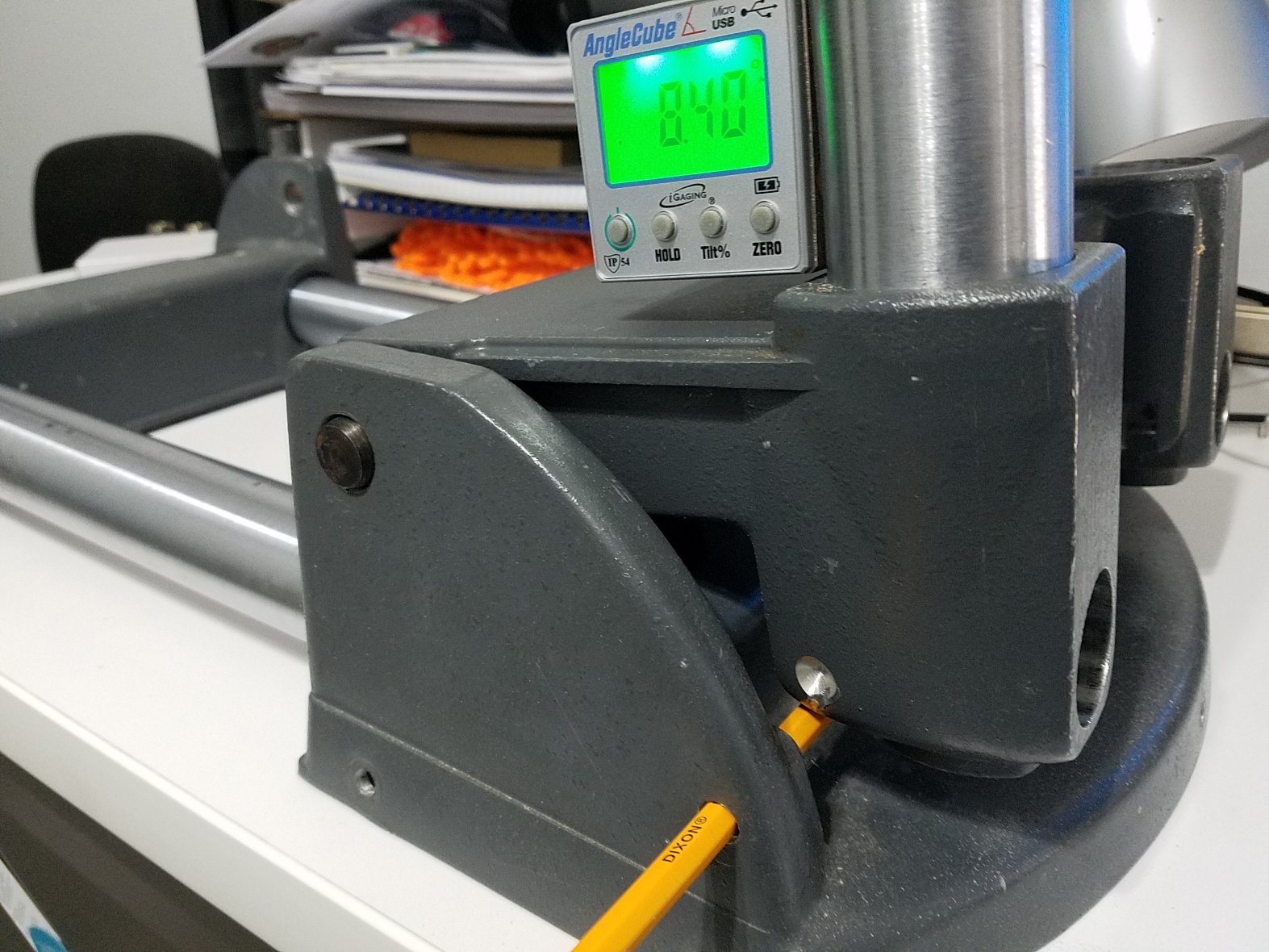

I really do not understand how this situation. as described here, could exist in the real world. I mocked up a system so I could see. Here are some pictures of my bench test.

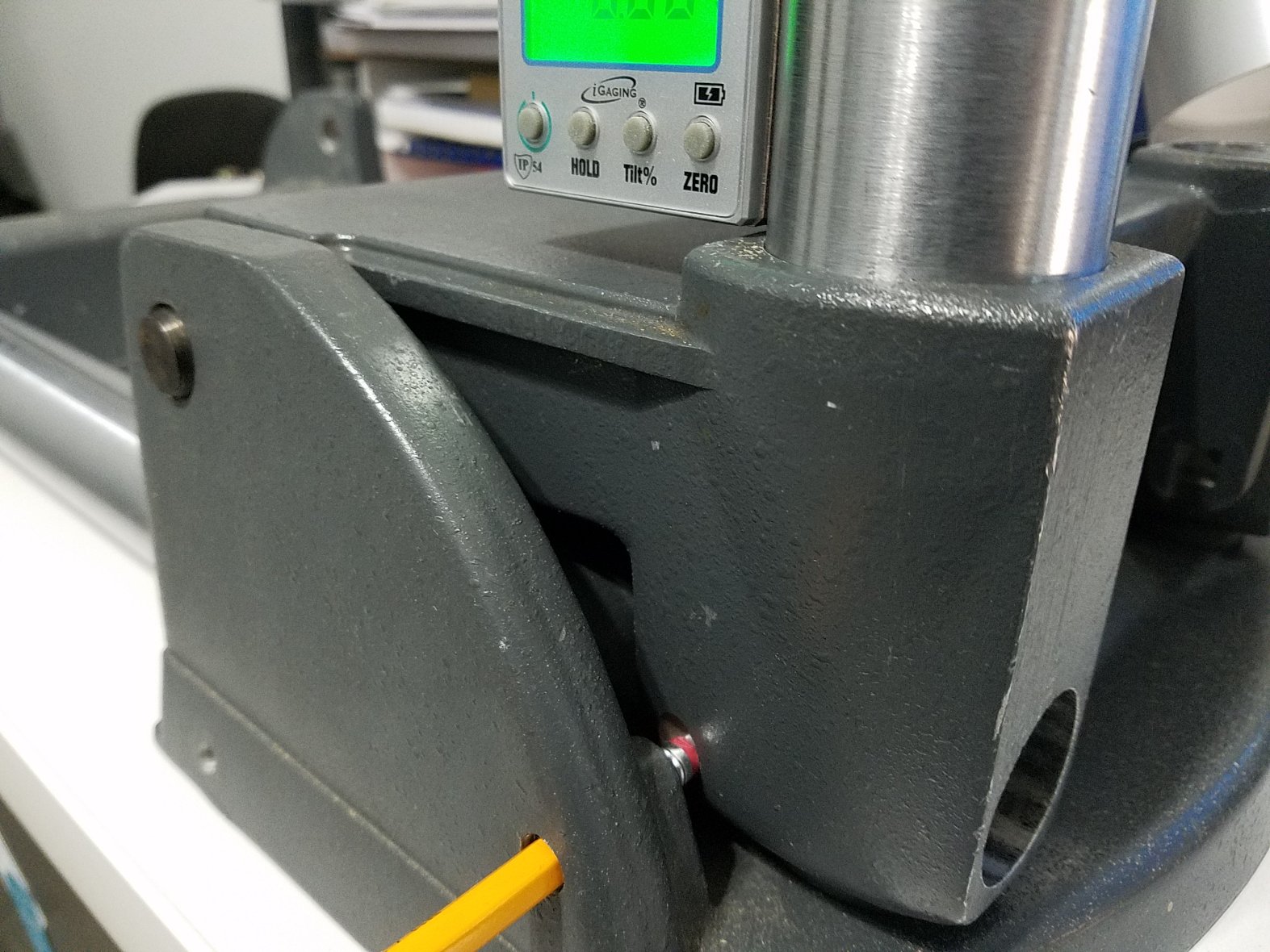

Could it possibly be something like this? :eek: If not, I have nothing else intelligent to offer. If thi.9s is no clue, maybe you need to do a similar set of images,
Forced Tilt with Stabilizing Bolt (aka Pencil)
Pencil Removed
Pencil Removed

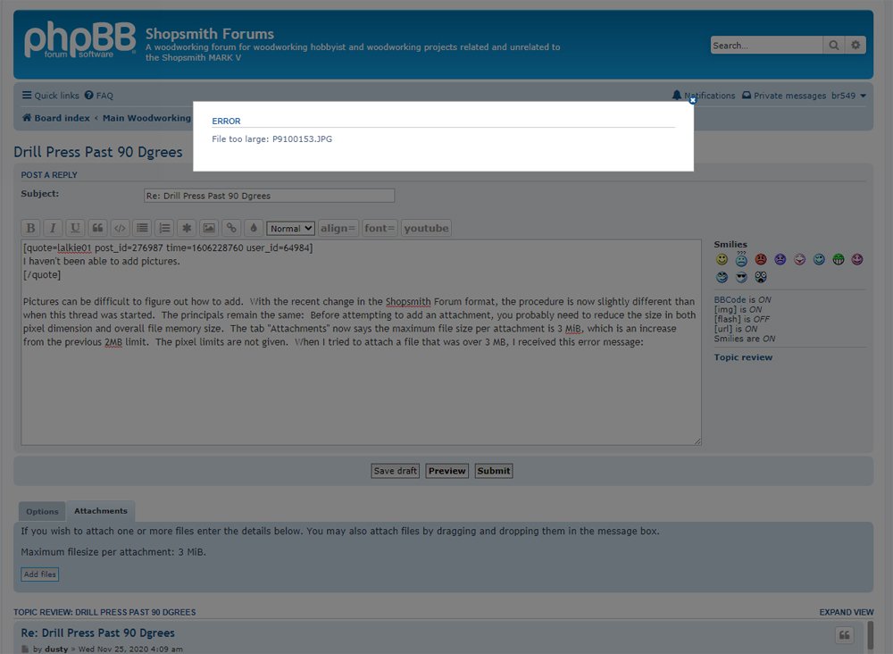

lalkie01 wrote: Tue Nov 24, 2020 9:39 am I haven't been able to add pictures.
Pictures can be difficult to figure out how to add, assuming that you are having difficulty with the software and not just unable to find your camera or time to do it. With the recent change in the Shopsmith Forum format, the procedure is now slightly different than when this thread was started. viewtopic.php?f=7&t=19246 The principles remain the same: Before attempting to add an attachment, you probably need to reduce the size in both pixel dimension and overall file memory size. The tab "Attachments" now says the maximum file size per attachment is 3 MiB. I had to Google what is the difference between MiB and MB and learned this: A megabyte is equal to 1,000,000 bytes. One mebibyte equals 1.048576 megabytes. The relatively small difference between the two is, in part, why they are often used synonymously. The previous was 2MB limit. The pixel limits are not given. When I tried to attach a file that was over 3 MB, I received this error message:
Error message.jpg (73.99 KiB) Viewed 1375 times
Just to try to find the upper limit, I then added a file that was 3000 dpi x 3000 dpi, and just under 3 MB, and it was able to be added just fine.
BB1al9CF 3000 dpi.jpg (218.81 KiB) Viewed 1375 times
Pictures of your machine would be a great help to everyone trying to help you figure out your problem.

Ponder the first three images that I just posted. Give attention to the 1.15 degrees and the .25 degrees. Not 90 degrees as you might expect.
If the tubes were at 90 degrees to the base arm the readings would be the same (0 degrees).
