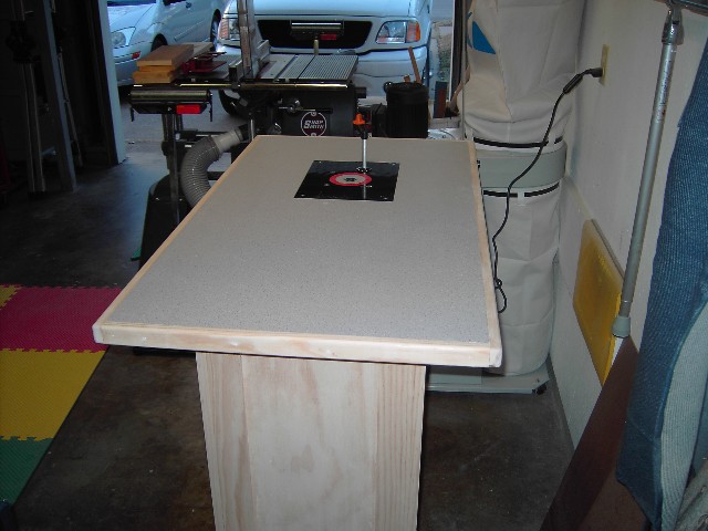

I really like my pro fence and router table setup but if I had it to do all over again - I would be looking for a better router table. I already see evidence that my table is losing its' flatness. I have a "slight" low spot around the insert which I believe is from the weight of the router.
If I am going to leave the table set up, I remove the router and insert (ie, I don't leave the router hanging in the table when I am not using it).

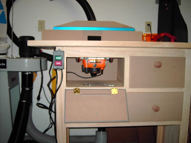

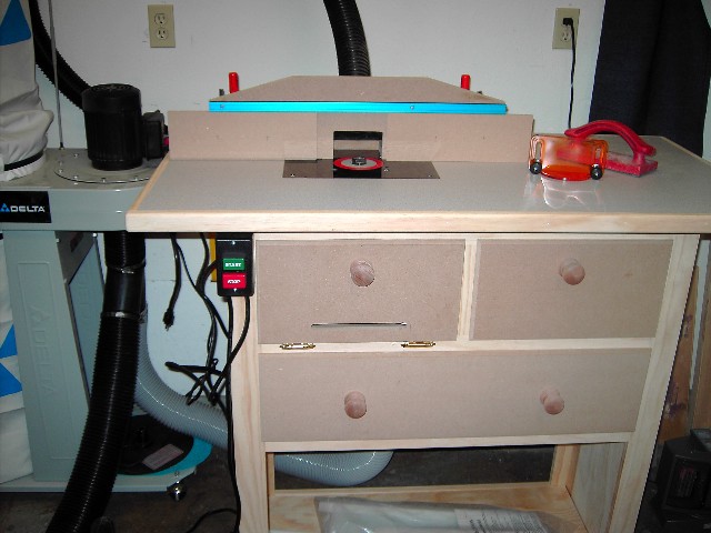

Speaking of sag, if you look closely at the first couple pictures, I have noticed the router insert sits down below the table about 1/8" or maybe more. Is there some type of shim that would need to be used to level this with the table? I would think since both are made by Jointech, they would have a bit better fit than that.
matpoh wrote:Speaking of sag, if you look closely at the first couple pictures, I have noticed the router insert sits down below the table about 1/8" or maybe more. Is there some type of shim that would need to be used to level this with the table? I would think since both are made by Jointech, they would have a bit better fit than that.
I think I see the "lip" (my words) that you question. If that really is a lip and not an optical allusion, I guarantee it is due to the fact that the insert has not be adjusted after being inserted into the table. I have used that system and the transition from table to insert can be made "virtually seamless".
The same can be said for the Shopsmith table and the Woodhaven insert. I believe both, if I recall the Jointech correctly, adjust to eliminate that transition in about the same fashion.
I believe the "sag" is a by product of a table made from MDF and is probably affected by humidity as well as the weight of the router. I have seen recommendations to treat all of the exposed surfaces of the MDF to reduce the effect of moisture on the table - this might be a wise tactic. It can't hurt.
I'm going to spend some time just staring at the table while mounted on the Mark V hoping to see a way that the weight factor can be offset (some sort of bracing).
Note the photos in my personal profile - there hangs the router. It's been that way for over a week.

My table top is made of 2 - 3/4" sheets of MDF glued together, covered with formica, top and bottom and edged with 3/4" strips of solid wood. For two years its had a big honking Triton mounted underneath and it hasn't shown any signs of sagging yet.I believe the "sag" is a by product of a table made from MDF and is probably affected by humidity as well as the weight of the router. I have seen recommendations to treat all of the exposed surfaces of the MDF to reduce the effect of moisture on the table - this might be a wise tactic. It can't hurt.
I agree that some type of bracing would help with the sag problem.
