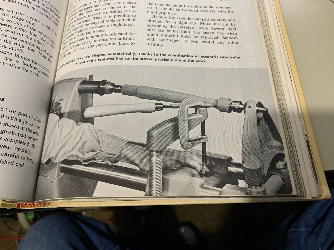

The idea is in one of the older the PTWFE, they don't use the face plate but simply clamp to the arm. When I have time I will try and find it and give you a page reference and edition.....
Re: precision spindle -Proof of concept -
This is the book, might be in other editions too?
Page 201:

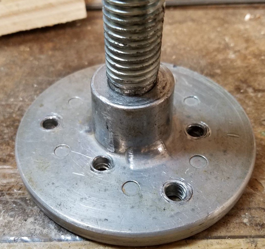

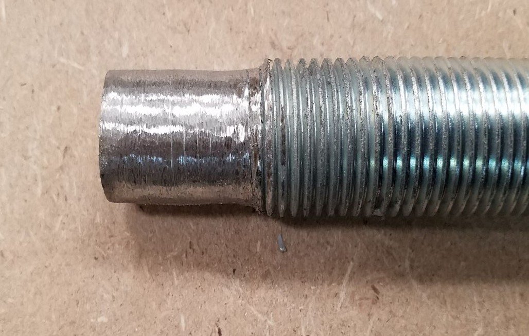

Ah - Now I understand. Was easy to take 3/4 threaded rod and grind one end down to 5/8. Made an adapter to connect a face plate to the tool rest arm SIMILAR to Reible using a tailstock chuck adapter for the same purpose. i.e. the low $$$ approach! Easy peasy. Thanks all.

hfmann wrote: Wed Dec 09, 2020 3:32 pm Ah - Now I understand. Was easy to take 3/4 threaded rod and grind one end down to 5/8. Easy peasy. Thanks all.

It's how I made my own tailstock adapter to work for Ed Reible's way to mount a gouge to the tool rest arm. Does that make sense now?

Change the wording - Made an adapter to connect a face plate to the tool rest arm SIMILAR to Reible using a tailstock chuck adapter for the same purpose. i.e. the low $$$ approach!
