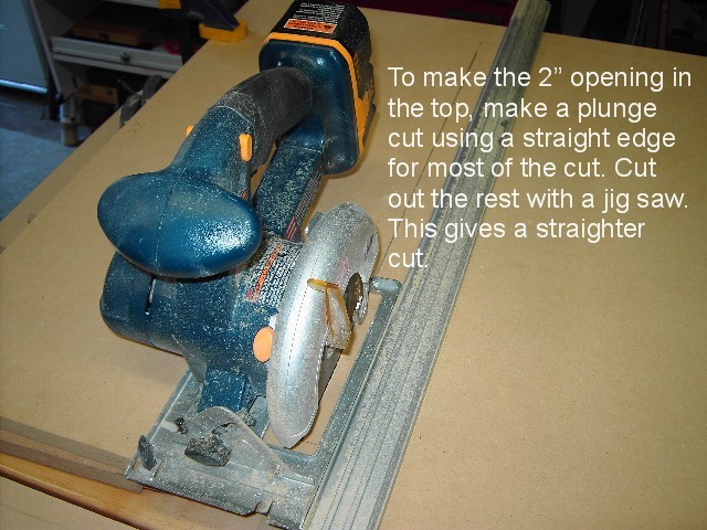

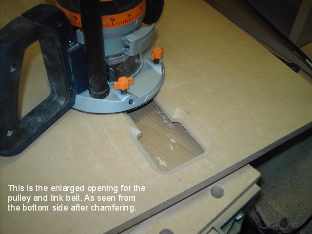

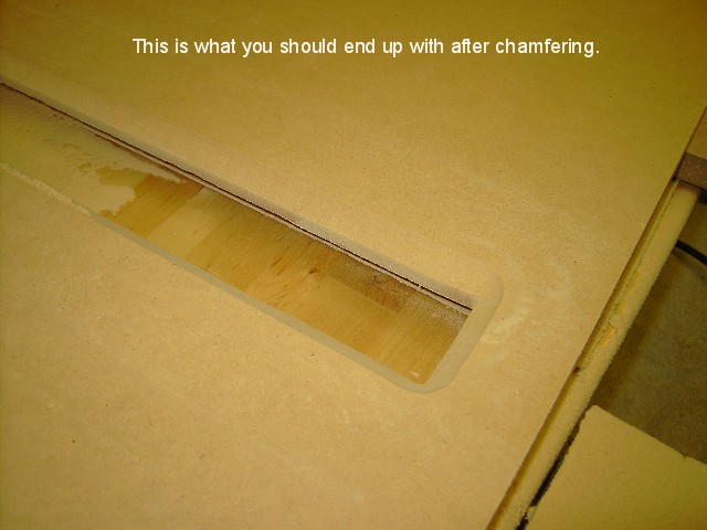

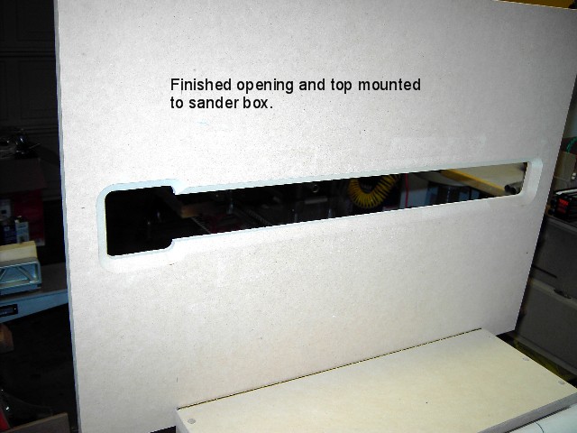

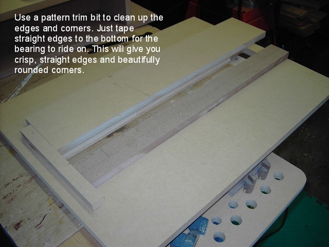

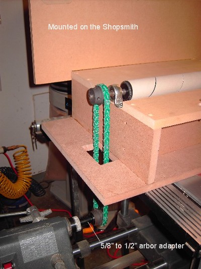

How I did it...
The attached photos show how I accomplished making the top for my Shopsmith powered V-Drum Sander.
- 1 Top.jpg (101.8 KiB) Viewed 2830 times
- 2 Top.jpg (73.12 KiB) Viewed 2813 times
- 3 Top.jpg (77.49 KiB) Viewed 2807 times
- 4 Top.jpg (59.01 KiB) Viewed 2809 times
- 5 Top.jpg (67.5 KiB) Viewed 2815 times
George

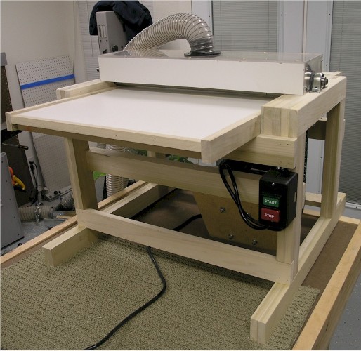

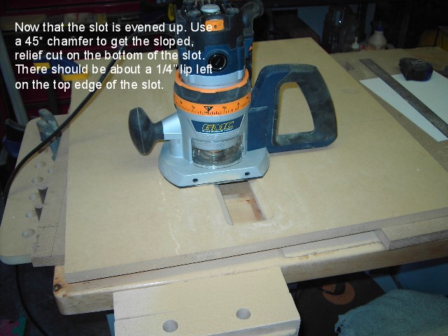

How I did it... Continued
I will have to take some links out of the belt so I can lower the table top to a more workable height. Other than that it works beautifully.
- 6 Top.jpg (68.66 KiB) Viewed 2808 times
- 7 Top.jpg (54.46 KiB) Viewed 2803 times
- Finished V-Drum Sander.jpg (94.58 KiB) Viewed 2822 times
- Test Hook-up.jpg (62.48 KiB) Viewed 2817 times

Nice work ol' curious one!!! How does it work for you with that belt driven hook-up. Looks easy to adjust the belt tension, have you had any problems here?
Looks good! And you've done a yeoman's job of showing us how to make a duplicate. You get an ATTA BOY, George!!:D
- curiousgeorge
- Posts: 880
- Location: Fort Worth, Texas
Hi Chuck,
Thanks for the atta boy. The belt drive works great. The kit comes with balanced pulleys and with the link belt there is no vibration at all. To adjust the belt tension simply raise or lower the saw table. Like I said earlier, I am going to remove some links from the belt so the table can be lowered to a more workable height.
I am working on a way to hook it up direct with the SPT coupler. The problem is the drum shaft is 1/2".
