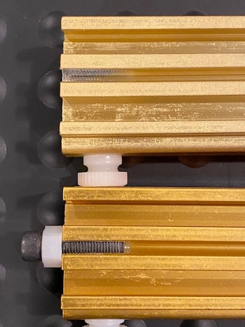

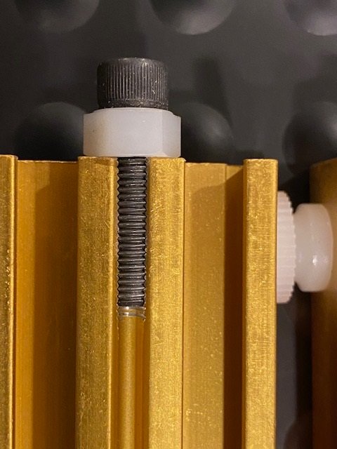

So, I got my 3rd sub-assembly from Incra for the Flip Shop Stop. The machining looks very good on this part and the threads were cleaned BEFORE the cap head screw was threaded in. This is exactly what I was expecting from Incra on my original purchase, not 3 deliveries later. Also note that it looks like the tap didn't wander (drift) upwards in the channel on this 3rd part like on the 1st & 2nd parts (look how deep that thread groove is in the bottom of the channel on this 3rd part). Enough said on that...
Now the color. I know this is personal preference and some of you might label me "whiney" for even bringing it up, but let's be honest. IF you purchased a new Mark V/7 expecting it to be the traditional grey and it came to your house and the headstock was pink would you accept it? I know I am exaggerating here, but hopefully you get my point. I really liked the original gold anodizing and red scheme of Incra products (as shown on pics from their website). In the pic below you can clearly see the difference between the older Incra products and the newer ones, i.e. no camera setting differences because both parts are in the same shot. I say this because I assume this 3rd part that they shipped me is probably a much older one they had sitting around. The newer manufactured parts look yellow to me, not gold, and kind of washed out. The original part has a true gold appearance that is much deeper in tone. It has an overall smoother finish whereas the new one is rough (like a casting on a brake caliper) due to the differences in tumble deburring processes between the two. Before the naysayers comment on this, keep in mind this is an expensive miter gauge package, i.e. a premium product (well over $200 total after tax & shipping). I have seen far better fit/finish on budget minded tools from Rockler or even some HF tools. There are even many China tools with better fit/finish than what I received. If you don't believe me check out a woodworker on YouTube under the channel name "Hooked On Wood" who does some excellent reviews of Chinese woodworking tools. While I am pleased to finally be able to put this one to bed, I am left saddened that this is the current state of manufacturing of many of our companies in this country today.
I mean can we not properly tap an aluminum extrusion any more? When it comes to metalworking, I am a hack but I am 99% sure I could do better (at tapping) than these 1st two parts from Incra.
IF I buy any more Incra tools, and that is a big IF, I will probably look for used ones in the future to try to get the better looking, better manufactured older ones.
Comparison (top is 2nd part and bottom is 3rd part): Close-Up of Threads in 3rd base:

Well, I am less inclined to throw it across the room in frustration so I would say it works much better now!!! So that is an improvement.
In all seriousness though, the cap head screw turns freely and smoothly in the extrusion of the Flip Shop Stop now, whereas the original one was crunching/grinding on the bits of metal shavings from the tap that weren't cleaned out.
