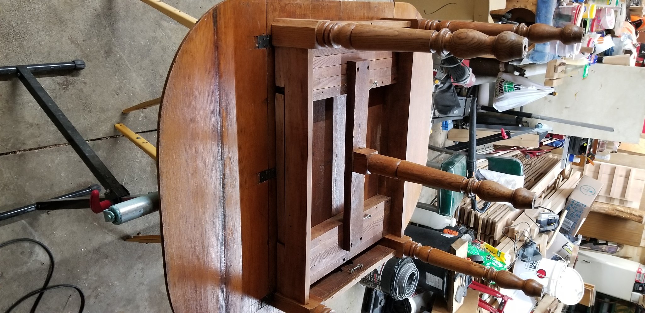

Those hinges look great, Hobbyman! I don't know what the finish would have looked like when new, but they sure look more authentic than chrome or shiny brass.
On the sliding dovetails, are the "dovetail ways" attached to one of the boards, or do they slide on both sides (with some sort of travel limiter)? From the pics, they appear to fit tightly in one side (only).

Thanks BuckeyeDennis , the male dovetails appear to be cut and inserted separately and attached only on each end to one of the slides . they do not appear to be cut the same length as the slides , there is a dowel pin inserted in the slides for a stop .

Getting closer this is the first trial fit .

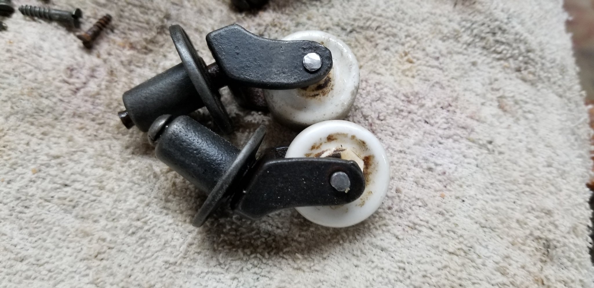

last night was interesting , managed to get a couple good coats of shellac on the tables top side , while waiting on the shellac to dry I decided to finish cleaning up the casters, I noticed one of the wheels on the casters was too large, so I used the Dremel and ground the end off the bad wheel's axle , made a new axle from a #8 nail ,switched out the wheel with one with a broken caster, haven't used a ballpein hammer on anything that small for many many years , glad I didnt break the caster body while I was smashing the ends flat , sort of felt like a blacksmith for a minute . going to allow the table to dry over night , do a final sand tomorrow and give it a final coat or 2 of finish , used a spray gun to apply the shellac instead of brushing it on , so far it has sucked up 2 quarts of sealer 3 quarts of shellac and about 1/4 gallon of denatured alcohol , all of the sliding parts have been coated with bees wax and are sliding like new money .

2 casters with their new wheels
