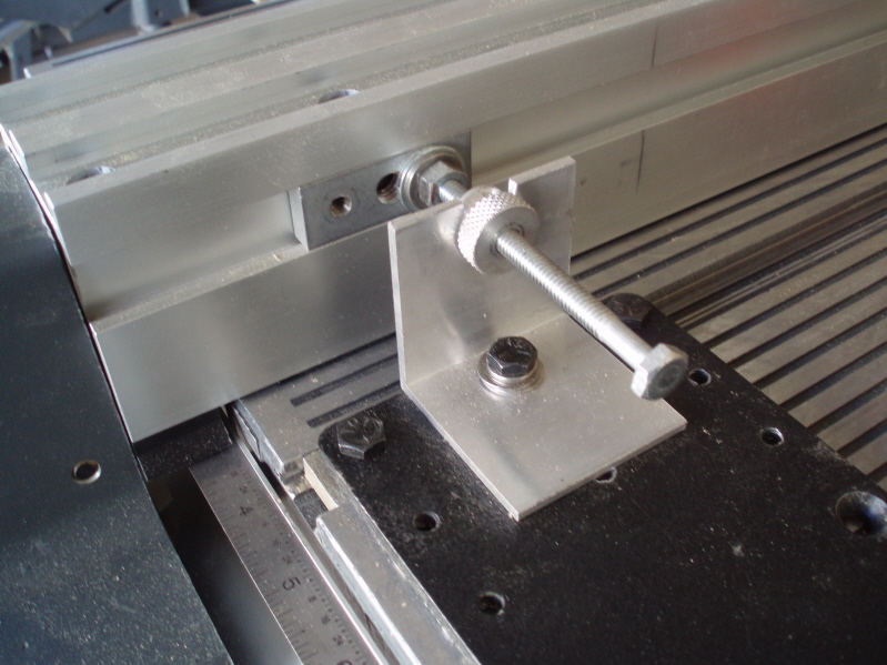

Dusty,
You have been working on a micro adjuster for the fence, so I thought I would see what I could come up with for my 520. I have a Vega fence on my Delta table saw with a micro adjuster that I do use once in a while, but never had one for the SS. I put this together today and it seems to work well in moving the fence a few thousands in or out. If the idea is worthwhile I am sure some of you will refine it into something that looks nice. The pics will give you the idea of what I did. Will answer any questions that I can.
ldh
ldh
- FenceAdj1.JPG (75.6 KiB) Viewed 6257 times
- FenceAdj2.JPG (56.58 KiB) Viewed 6246 times

You guys amaze me!
Awesome!
Idh, a miter bar mounted under the plywood and you wouldn't even need to clamp it.
Great ideas.
Awesome!
Great ideas.

As I said, you folks will refine it. Good idea John, one might even use one of the short ones that can be locked in place. With the clamp you have zero slap for those who want it down to the thousands and the rip dimension can be greater.pinkiewerewolf wrote:You guys amaze me!

I don't see why it needs to be refined at all. It looks great and you said it works. This is all the counts. Along with the fact that you didn't have to pay big bucks makes this fantastic. Great Job.ldh wrote:Dusty,
ldh
I am having a bit of trouble with mine. The adjusting knob is too small. My finger strength is inadequate to move the adjustment. Need a bigger knob.
Didn't want to have to buy anything. The most points are awarded for "use of existing materials". I'm going to get zero points in that category on this one.
Thanks for the inputs though. You have given me some ideas. Pictures will follow when something materializes.

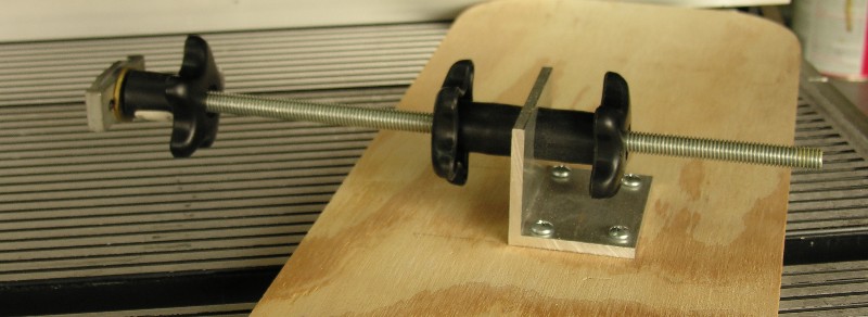

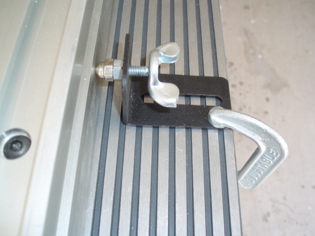

Did you have to drill through the knobs that you used or did you buy them this way (so that the rod goes all the way through).
I have completed my proof of concept model. It works but I want a larger knob and I want to use a finer thread than I did for this one.
My going in position is that I will purchase nothing to build these jigs. It is my objective to use materials already in the shop.
[ATTACH]2530[/ATTACH]
[ATTACH]2534[/ATTACH]
[ATTACH]2535[/ATTACH]
