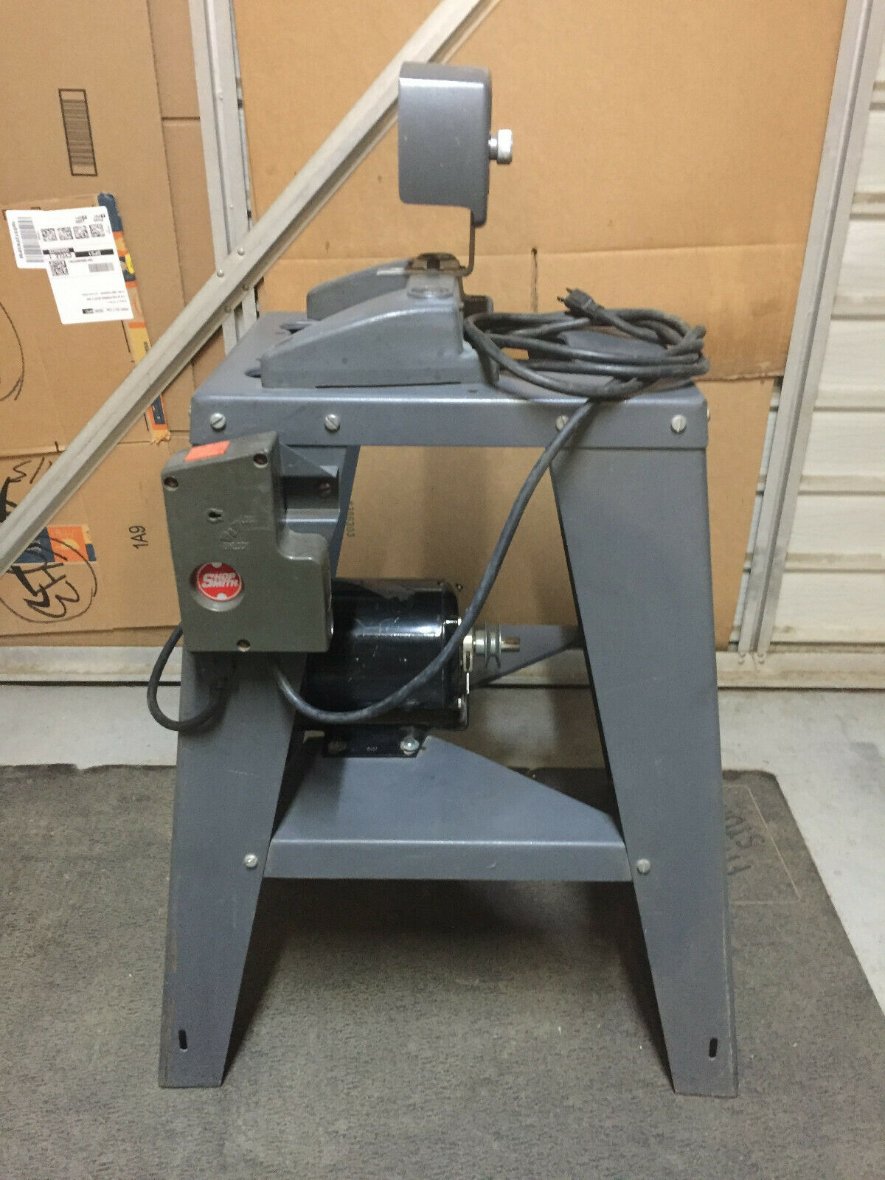

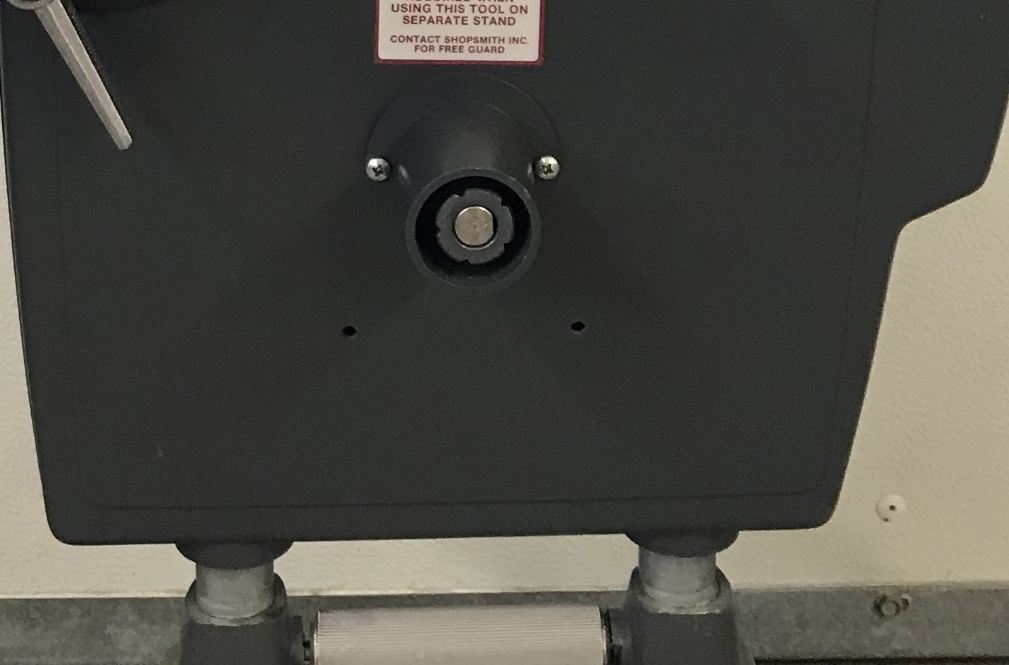

Someone on My Growth Rings asked what these two holes in the bandsaw case were for:
I had no idea at first. Then I checked a saw that came mounted on a Power Stand. The holes fit a bracket for a belt and pulley guard shown below. The holes and internal reinforcement are cast into the case. They are on all the gray bandsaws I have. No idea if they were there in the earlier Magna and Yuba versions. You can probably check on those.
