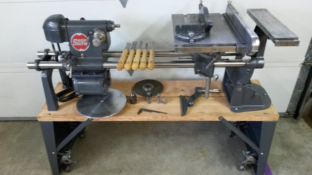

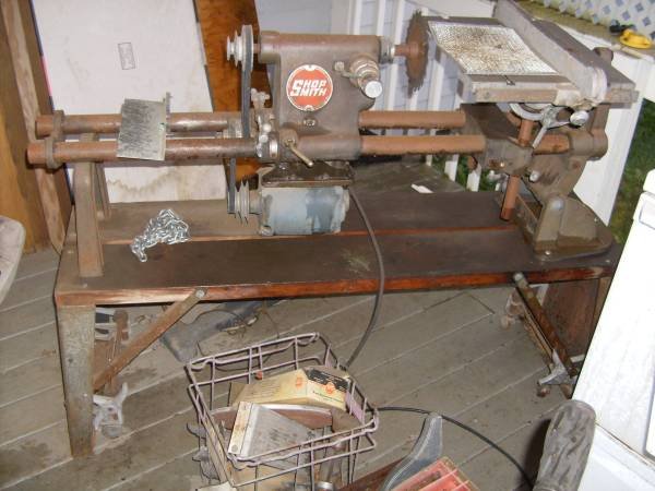

Below is a Model 10ER I restored in a condition near to yours. It is not the worst condition I have found one in and restored though.
_
_
Below is the same Model 10ER after restoration.
_
_
Even a tool that looks like a "basket case" can be brought back to life. For the one above I mainly used vinegar as a rust remover. I have used Evaporust too but have not tried electrolysis. Evaporust works quicker than vinegar but also cost more. Since it is a weak acid there are parts that vinegar should not be used on. Alloy parts attached to steel or cast iron parts needing de-rusting can be damaged by vinegar/acid. Some collars are alloy and there are steel/alloy combination assemblies used on the Jig Saw. For the way tubes I have a PVC pipe with a glued on cap on one end and press the cap on the other. It's the best way I have used for de-rusting the way tubes. After three days in the vinegar the way tube is ready to be rinsed/neutralized, dried and polished. That was the process used for the way tubes shown above.
