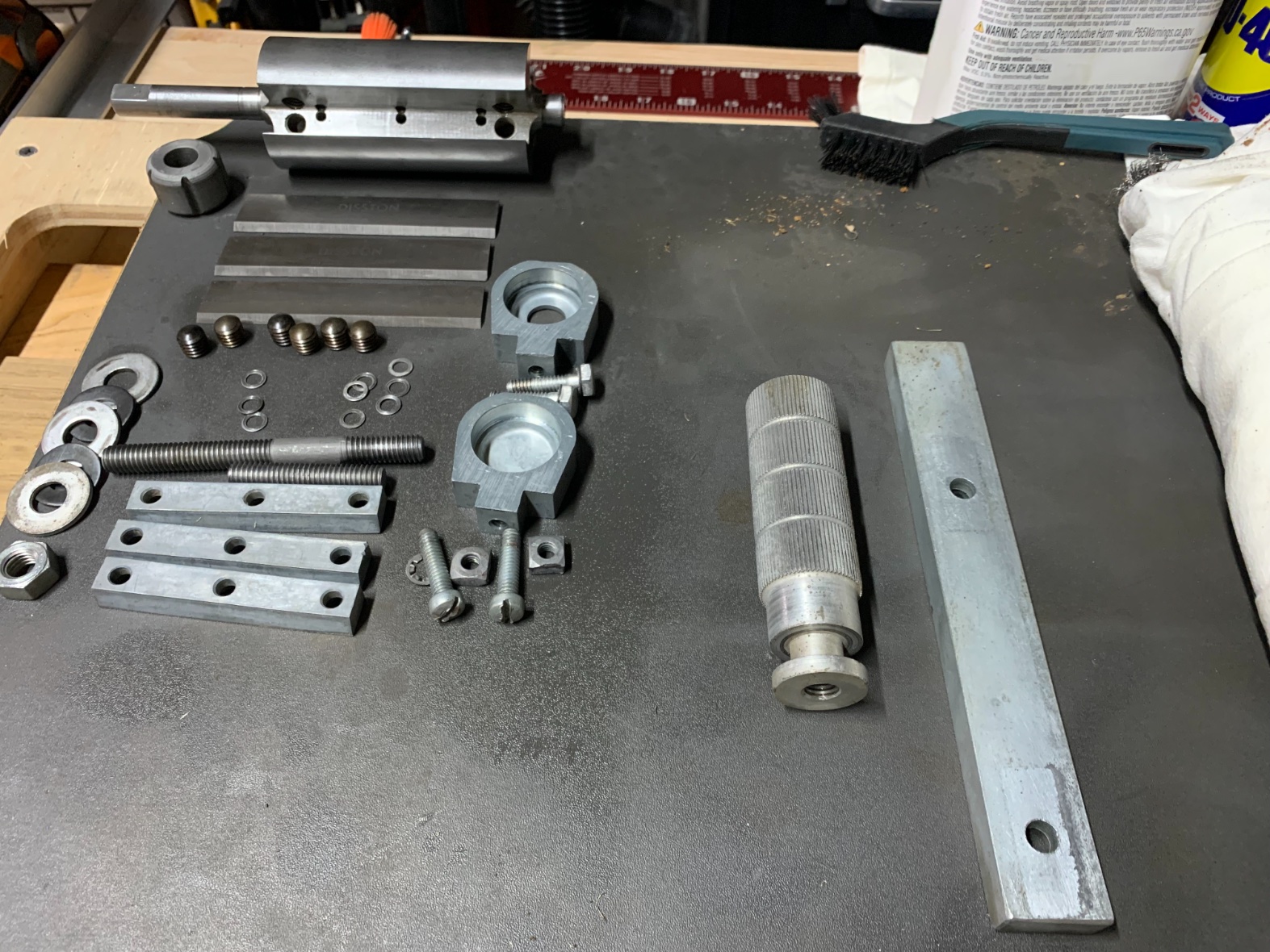

Because of their dull gray coloring, I initially thought the fence adjustment bar on the right side of the infeed table and the depth adjustment knob were both made of aluminum. I did think that would be very strange because of the weight and stresses on these parts would be high. Still, I thought it was weird that I found no rust on either of these parts. Since they are heavier than I would expect I’m pretty sure they are not made of aluminum. Does anyone know what material these two parts are made of?
Here are a couple of photos of my progress.

I am not totally sure which parts you are asking about but if the fence adjustment bar is P/N B 2793 Bar-Fence from the 1956 Owner's Manual that is steel and is the bottom part shown in the lower picture of the Jointer parts above. If the depth adjustment knob is P/N B 3557 Knob-Adjusting from the same manual it is aluminum or an alloy. That knob is not shown in either of your pictures above. Yours would be the earlier version of the Table Height Adjusting Knob than the one shown in the 1956 Owner's Manual. That knob (originally P/N A 2912 Knob-Adjusting) and the Depth Adjusting Screw (originally P/N A 2951 Screw-Depth) was the first change made to the Model 620 Jointer. Those part numbers (A 2951 Screw-Depth and A 2912 Knob-Adjusting) are from the Model 4E Jointer Owner's Manual I have. Sorry I don't have the first Model 620 Owner's Manual that would be the one for your Jointer but many of the part numbers are the same as long as the parts themselves didn't change. P/N B 2793 Bar-Fence is the same part number shown in both manuals I referenced.

Russ, you were correct on both parts. I retook the photo to show them on the right side of shot below. I don’t thing the knob is aluminum. If it were allot, I wonder what that would mean. The end caps that hold the cutter head bearings are definitely aluminum.

I just realized that I could easily figure out whether the knob was steel, or at least was some ferrous alloy; just use a magnet!!! A magnet sticks strongly to it, so that question is answered.
Thanks to Russ, your post led me to look closer at the manual I have and I can clearly see my knob is a lot different shape from what is shown there.

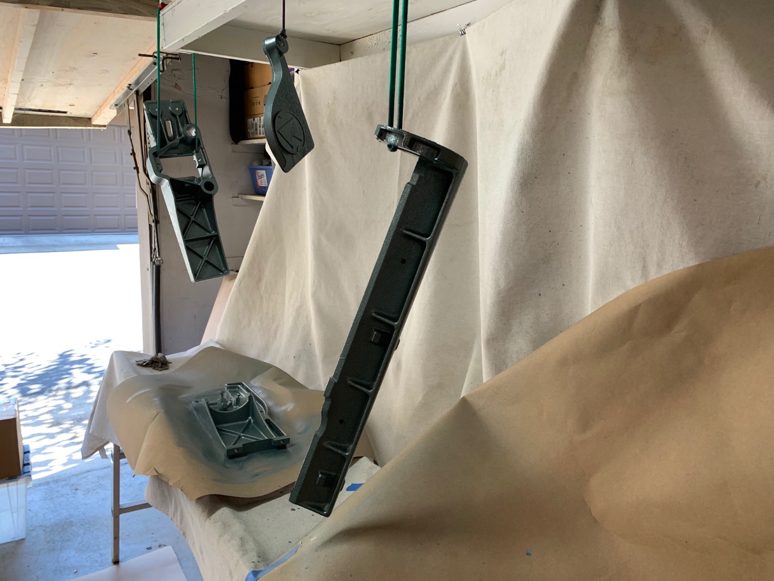

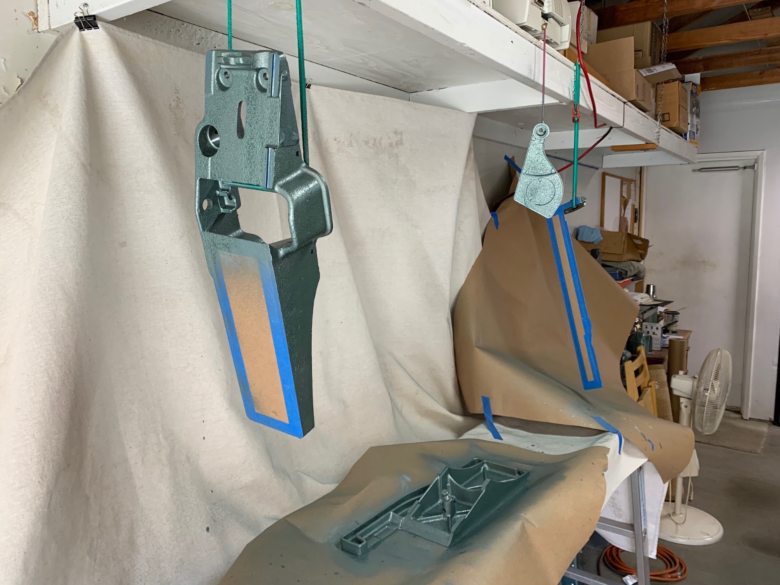

Today is painting day. Waiting for them to dry. Looking forward to getting it back together and off my bench! :D

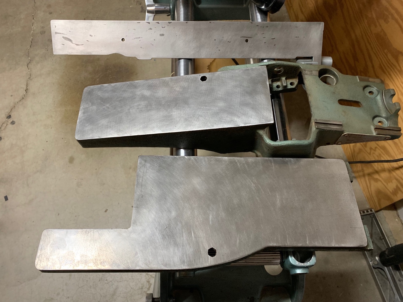

I cannot tell from the picture if you covered the contact points, most indicated by the red arrows, between the base/outfeed table and the infeed table. Do make sure there is no paint on on the four contact points on each part before reassembling. Paint will end up acting like glue. Those contact points should be bare metal to bare metal contact and waxed for protection and lubrication.
_
Marc 620 Jointer painted arrows.jpg (325.89 KiB) Viewed 1234 times

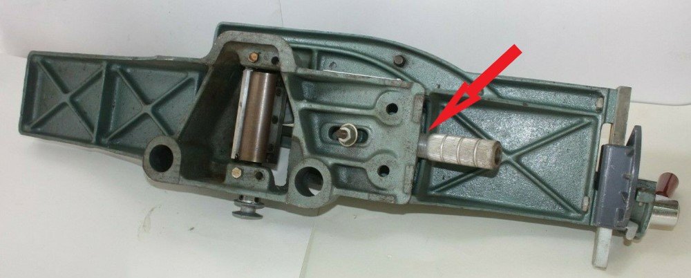

Near where indicated by the arrow in the picture below, the semi-circle the adjustment handle sits in can have the paint removed too. Waxing the then bare metal will help the adjustment handle turn easier than if that point on the base/outfeed table has paint.
