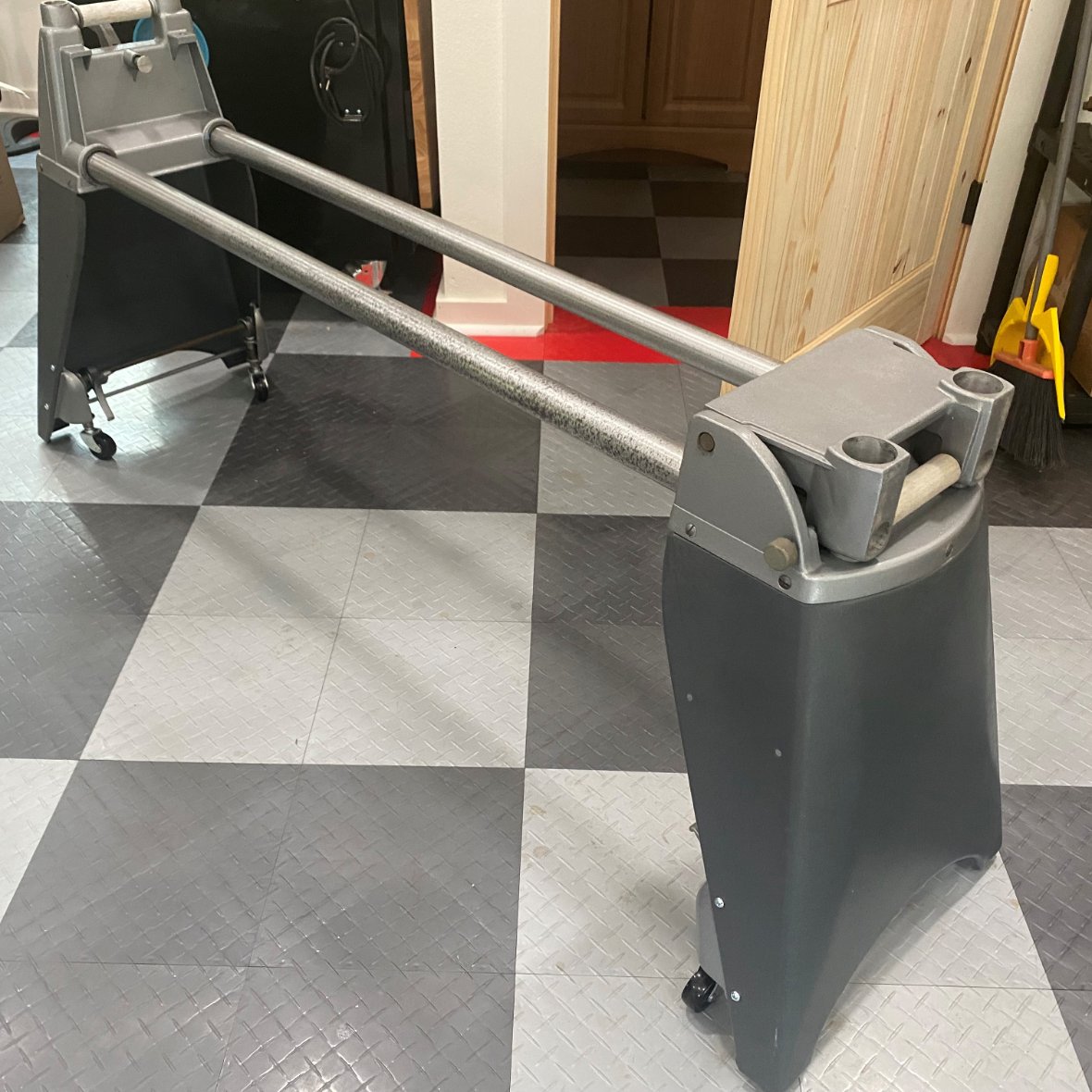

Big step, I have a base assembly.
Re: Refurbishing a MkV 510
BTW, does anyone know the measurement between the base legs, or do I adjust to the way tubes when I get there?
Thanks.
Thanks.

What measurement?
The bench tubes should be inserted into the base castings so the end of the tube touches a small stop rib.
The bench tube separation is determined by side motion stops in the base casting. The clamp pushes the tubes out against the stops.
The end with the tie bar lock has stops, the other base piece didn’t.
Measure the depth of insertion on the other end and match it.
The real test comes when you put the way tubes in. Sink them all the way into the castings, check for square and level (not twisted) and then lock it down. If the locking mechanism isn't smooth you might need to loosen those legs and tweak but I don't expect that will be necessary.
This is the time to be real fussy about about dimensions. Square, plumb, level and tight. It will be easier now because the headstock and carriage are out of the way. It will payoff later when you do the alignments.
Nice work thus far. Don't rush to the end.
BTW - the measurement that you ask about will be very close to 48 3/8" as will be the way tubes.Whatever they are, measure the diagonals for equality.

Thanks very much, gives me a great starting point. The way tubes are cleaning up nicely, some staining, but no pitting, so I think they’ll be good. I still have to dive into the headstock. Based on the S/N, looks like the machine dates to 1984, so I’m sure there’s a lot of work in there.
