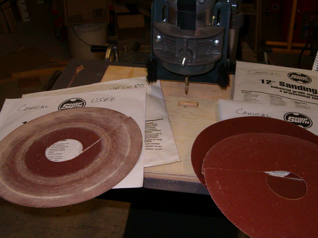

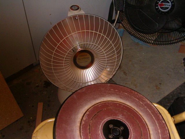

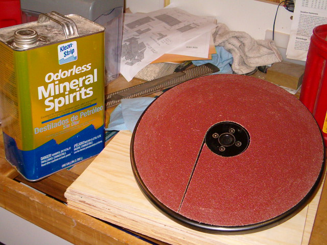

Got the disk out of the cupboard. It was cold! I put the disk in front of the heater for 1 hour, from 11 to 12 AM. It was almost too hot to handle. Removed the 80 grit that was on the disk and replaced it with some heavily worn/abused 150 grit. In fact this is the ripped disk I mentioned earlier. Went in for lunch and to get the camera. After the disk cooled down for an hour (lunch) the old sandpaper was well adhered.
Re- warmed the disk again (15 minutes this time) removed the old abused paper and re-installed the original disk.
Cleaned the disk after each removal with mineral spirits. All glue is still on the sandpaper backs. As long as the metal disk is thoroughly warmed, there is no problem changing sandpaper and getting god adherence, as long as paper and disk is clean. BTW - the original 80 grit paper had been on the disk for several months.
