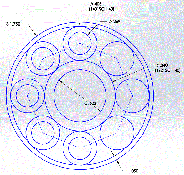

Continuing with the idea of fixing the new Shopsmith tubes, it appears that 7 pieces of Schedule 40 or 80 1/4" pipe will fit into a 1.75 OD, 0.050" wall tube as shown in the attachment. Not a zero-clearance fit but wrapping the pipes with ductape could remedy that.
Steel pipes stuffed into the tubes certainly would increase stiffness. The added weight would be a plus in some applications. Machine damping could be improved by filling each pipe with something like asphalt or pearlite-plaster (structo-lite). This 7-pipe arrangement could be installed without pulling out those new end bushings - 6 pipes go in first and then the seventh goes in the middle.
Additional 9 pipe configuration attached. This combination is an exact fit with the tube ID.
So who is going to be the beta tester of this??
Seven identical pipes
PIPE IN TUBING.GIF (133.26 KiB) Viewed 1948 times
Nine pipes - exact fit
PIPE IN TUBING 3.GIF (135.79 KiB) Viewed 1929 times
