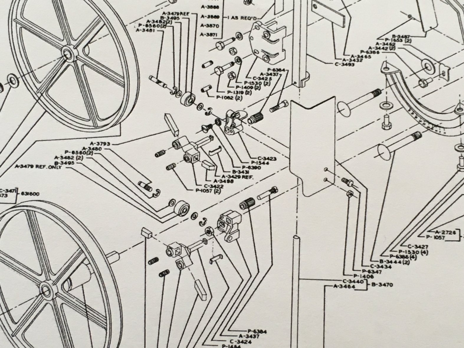

Re: new guy - new / old machine
found it,,,
the attached parts layout shows how the roller bearing on my old 1983 saw really are... the slotted screw with c-clips on both sides of the bearing.
found this is a Magna model 630 manual. Anyone know the year Magna became Shopsmith ?
