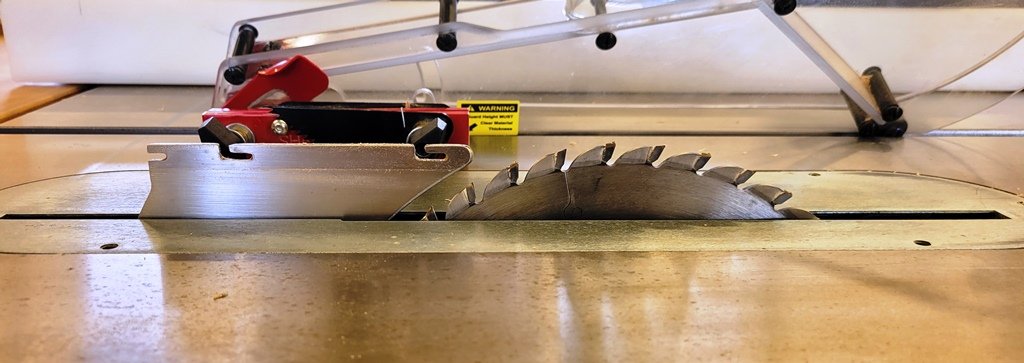

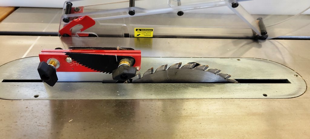

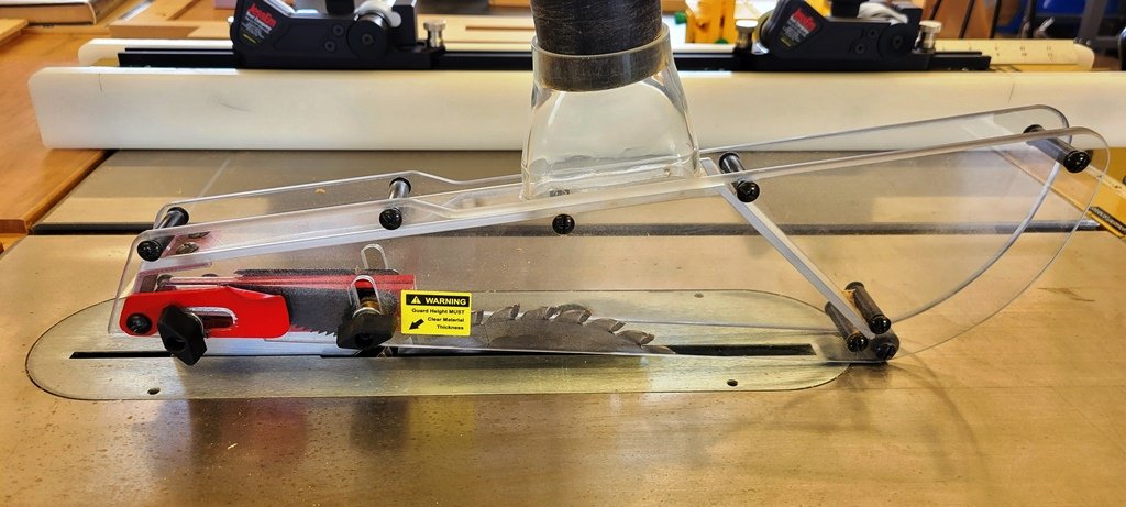

IMO, a properly designed upper saw blade guard should include a riving knife that allows non-through cuts. This is the Shark Guard on my Powermatic PM2000. You can remove the blade guard itself and are left with a riving knife for non-through cuts.
