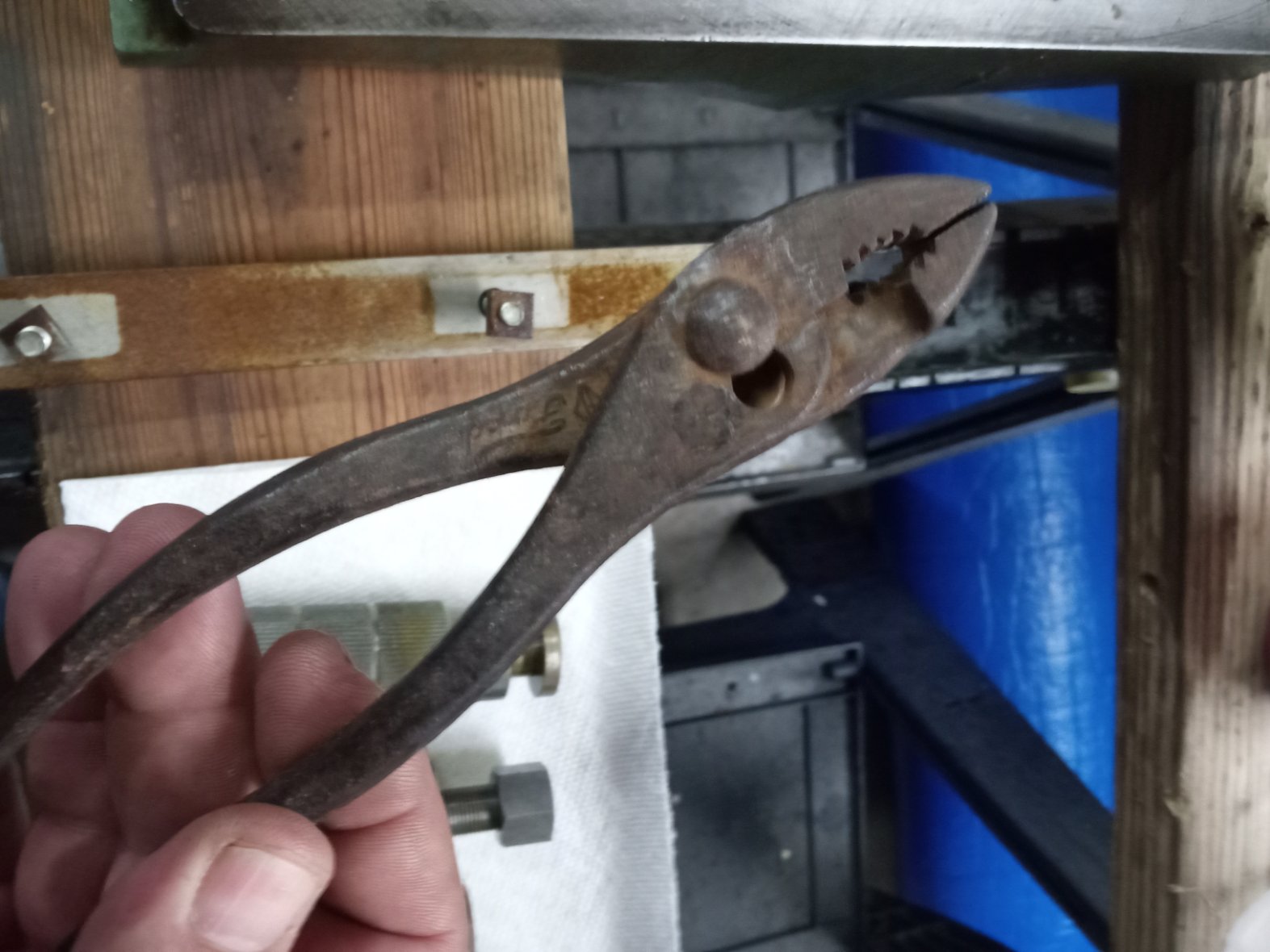

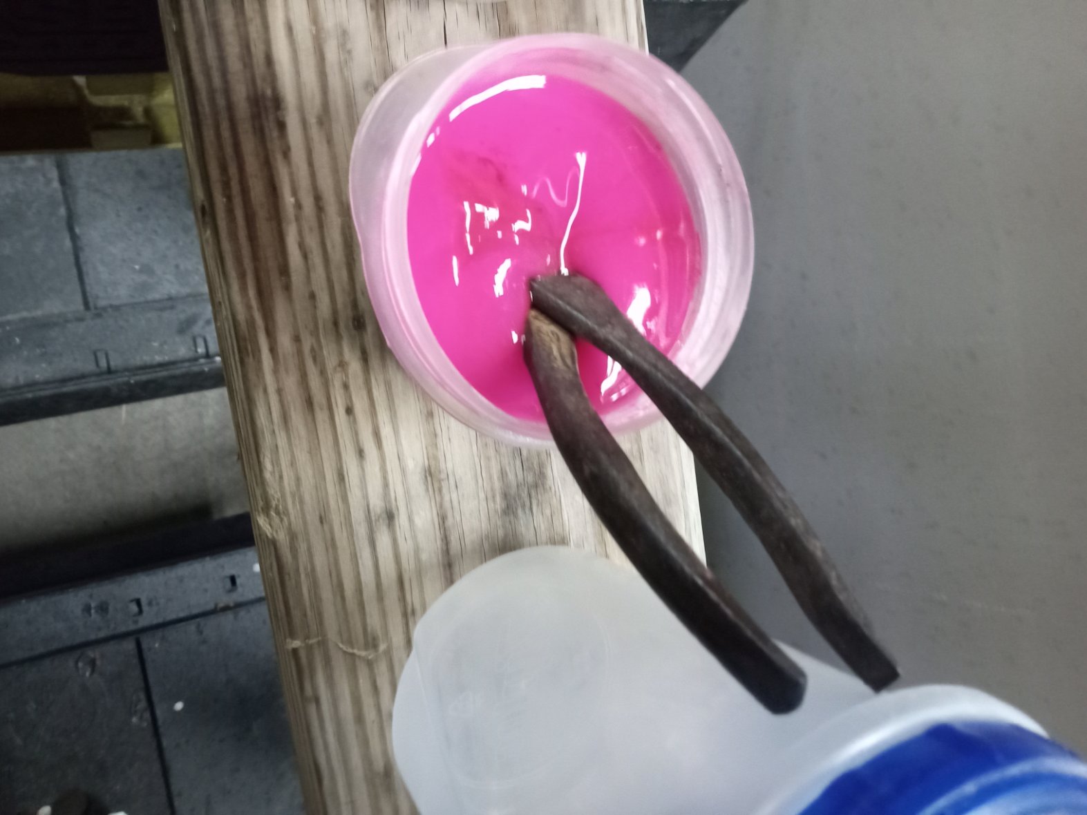

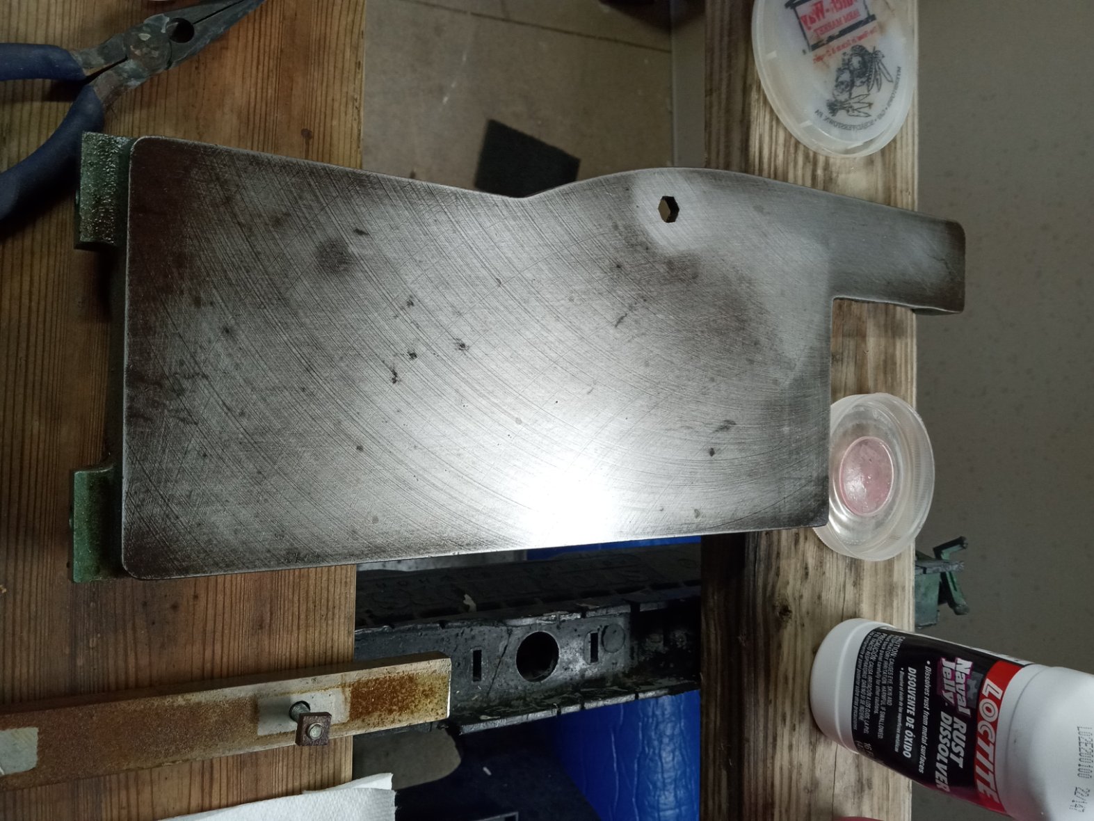

I have not used chemicals on the Jointer Deck Parts, the paint on them are really nice. I have been just using WD40 and scotch brite pads. The Milling marking on these are very prominent and easy to see. I think I will be stepping down sand paper on the 6 inch DA to get the surface in better shape. I can get DA paper that starts at 80 grit and walk it down to 8000 grit, however 1500 should be as low as needed.
All of the parts shown in the pics had a really good coat of rust, the drill chuck would only turn with the chuck key. After a bit day in the jelly, water rinsed and WD 40 applied, they all look really good. Those bits I will be hitting with the Super Blue. I still need to sort out how the chuck comes apart so I can deal with the innereds.
