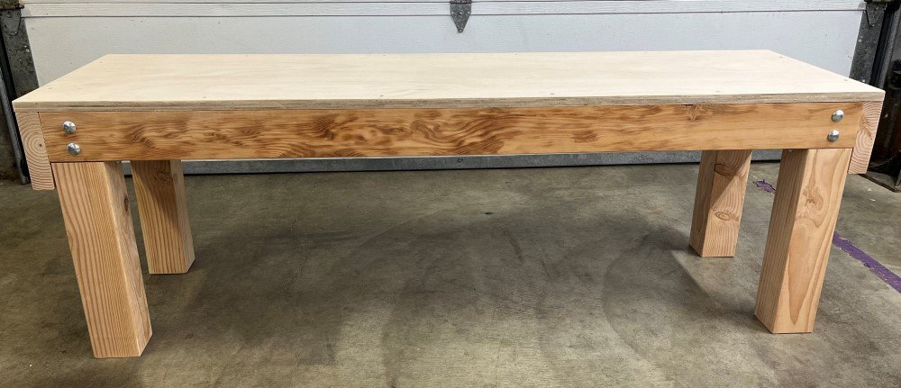

I thought you might enjoy seeing a bench I made for my Model 10E. It follows one of the two Wood Bench plans Magna included with the Model 10's. This one marked 160-2 also includes the plans for a rack for Shopsmith Attachments on the back side. I plan to make one of those racks. I preferred this plan over the other plan which may have actually been the first plan included with the Model 10E. I actually made two of these benches just before I went on vacation but have not put a finish on them yet. On the one below I will move Model 10E S/N 1077 from its current Shopsmith metal bench end and 2 x 8 boards bench with retractable casters to this one. When restored, I will put Model 10E S/N 1076 on the second matching bench. I am adding the retractable casters to both of these wood benches. It is nice the retractable casters were designed to fit both the metal end benches and these wood benches from the Magna plans.
_
Bench for 10E 1077.jpg (91 KiB) Viewed 3839 times
I still haven't decided if I want to stain the wood or just a clear finish. I am leaning toward just a clear finish to protect the wood as most probably didn't have a finish put on them back then. The 2 X 4's on both benches under the top have some history as they came from my house built in 1957 during a remodel I did. They are from 4 wall studs. I liked being able to use them as they added some extra character to the project.

chapmanruss wrote: Fri Aug 05, 2022 1:22 pm I still haven't decided if I want to stain the wood or just a clear finish. I am leaning toward just a clear finish to protect the wood as most probably didn't have a finish put on them back then. The 2 X 4's on both benches under the top have some history as they came from my house built in 1957 during a remodel I did. They are from 4 wall studs. I liked being able to use them as they added some extra character to the project.
That's a great looking bench! i like material with a history. I noticed you upgraded the legs to 4x4 and rabet joined them, that's a nice way to add a wider stance and make it more stable.
The version of blueprints i have call for "finished" wood in the parts list. l for the 2x4 and 2x6 top frame. I assume this was pre-finished clear coated dimensional lumber. Not even sure if that is sold anymore besides in craft stores.

The Blueprint of the Bench Plan you show the upper right corner of above is different than the two bench plans I have. It must be a third one I haven't seen before. It calls for 1 Piece 2" X 4" X 8' for the legs whereas the one I used calls for 1 Piece 4" X 4" X 7' for the legs. Everything else appears to be the same. The plan I used calls for that rabbit cut to fit as shown in the PDF of the plans I used below. I would be interested in seeing the complete bench plan you showed the corner of in your post above. If you can scan it as a PDF and post it here others may be interested too.

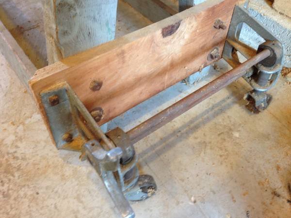

Thanks for a glimpse of the Bench Plans in the video. It does appear those plans are the same as the one I used except yours uses 2 x 4's for the legs instead of 4 x 4's. For yours you opted using three 2 x 6's in place of the 3/4" plywood top as suggested in the plans. The only downside I see to the 2 x 4 legs is you cannot mount the Retractable Casters directly to them because of the spacing. The Retractable Casters mount on 15 1/2" centers. They can be attached using an additional board like the one shown in the picture below. This was from a 10ER I restored over 8 years ago that came on a wooden bench with the Retractable Casters mounted outboard to the bench legs. That wood bench was not built like any of the three Shopsmith/Magna Bench Plans I have now seen.

I will upload the blueprints and manual shortly, the evolution of the bench is interesting. I definitely need casters to move this thing around so i may make some wood end bars like in your picture. I will need to source some casters too if you know where I can find them.
