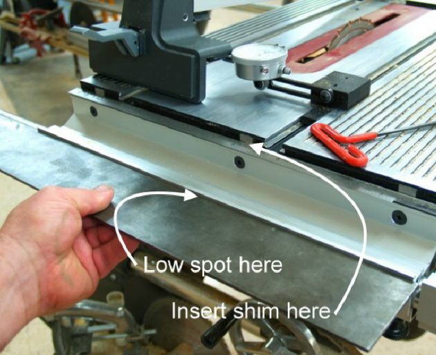

Shims required to align front rail.
[ATTACH]4534[/ATTACH]
- Straightedge.JPG (160.2 KiB) Viewed 9213 times

To finish off my (whining) portion of this thread, here goes. Oh, btw, glad you found your solution Bruce, good to hear (and file away, for if ever needed).
I think the old measurements between tables that I published earlier were irrelevant because my ole Main table was defective. But what remains is a real stinker.
The RAILS are the problem. (Remember this is a 510-R.)
I'd get the Ext table lined up to the Main, I thought, then when the connector tubes got tightened the rails just pulled out of line. Everything "seemed" to be the same size and all...
Then just for the heck of it, decided to check the rail dimensions, and saw a strange thing-- the inner diameters were different.
Whut?
Well, with the outer diameters the same, that means only one possible thing.
We've all been focusing on the 'positions' of the rails, but not the Sizes!
Yep, the outermost point of the rail-- the part the Fence gets SET against-- got knocked off because the INNER diameters of the rails are different!
Inner D Main rail = 1-1/16; Inner D Aux table rails = 1-1/8, meaning the wall thicknesses of the different rails are Different! {When the tube puts the inner wall of two connecting rails in a plane, the outer wall of the Aux table rail is then a full 1/32" further out.}
No shims can fix this.
But it looks like one thing and one thing only CAN fix it.
I be watching my e-mail for the next SS sale on 520 ProFence upgrade.
Thanks to everyone for your inputs, without which I probably would have (again) just thrown up my hands in despair and thrown a cover over the SS (again) for another year or two.
