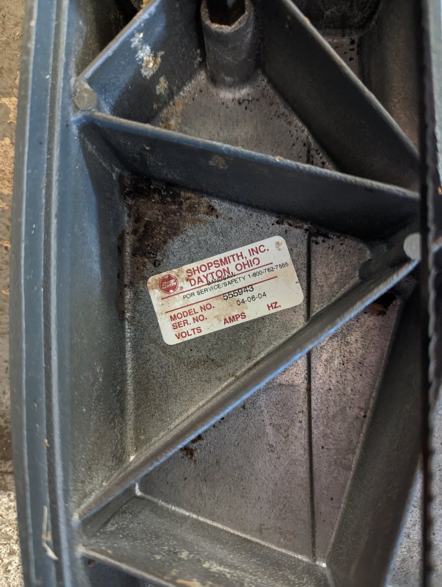

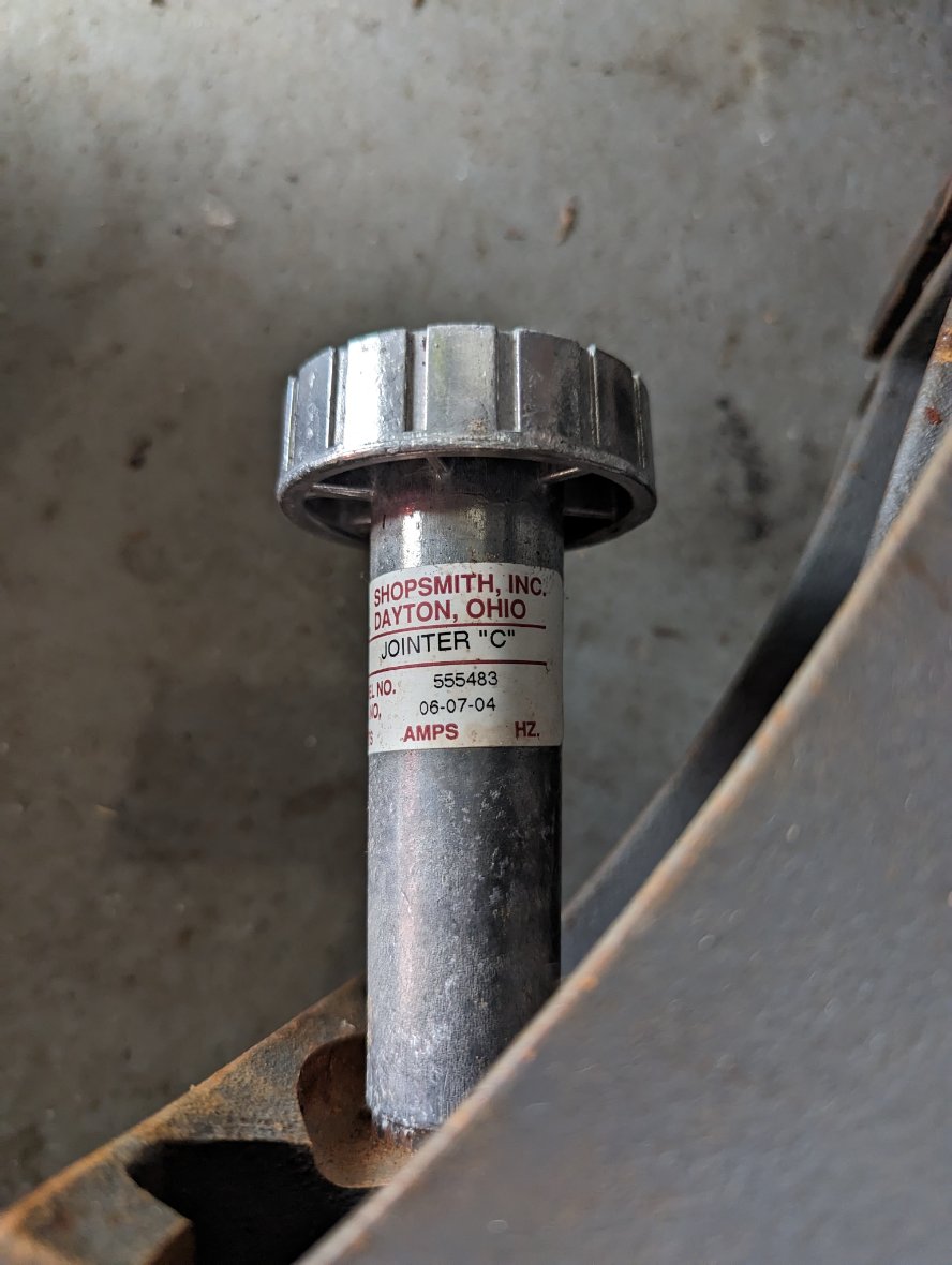

I'm attaching some pics of the date tags on the band saw and the jointer. Both show a 2004 build date. (I found the tag inside the band saw after I vacuumed out a mouse nest, lol.) I couldn't find a tag on the belt sander anywhere. If we assume all of the stuff was bought at the same time, then the assumption is that the Mark V is also from 2004-ish. Is knowing the paint formula only important for the sake of getting an exact match on the paint color? Or is there some other concern (like a switch from enamel to acrylic)?

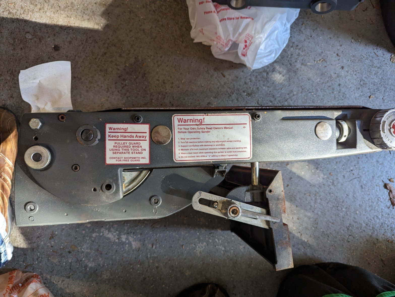

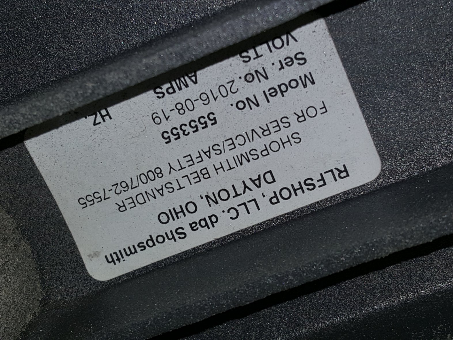

Look for the belt sander one on the inside of the grey sides.
Brenda
1998 bandsaw
2016 beltsander
jointer
overarm pin router
1998 bandsaw
2016 beltsander
jointer
overarm pin router

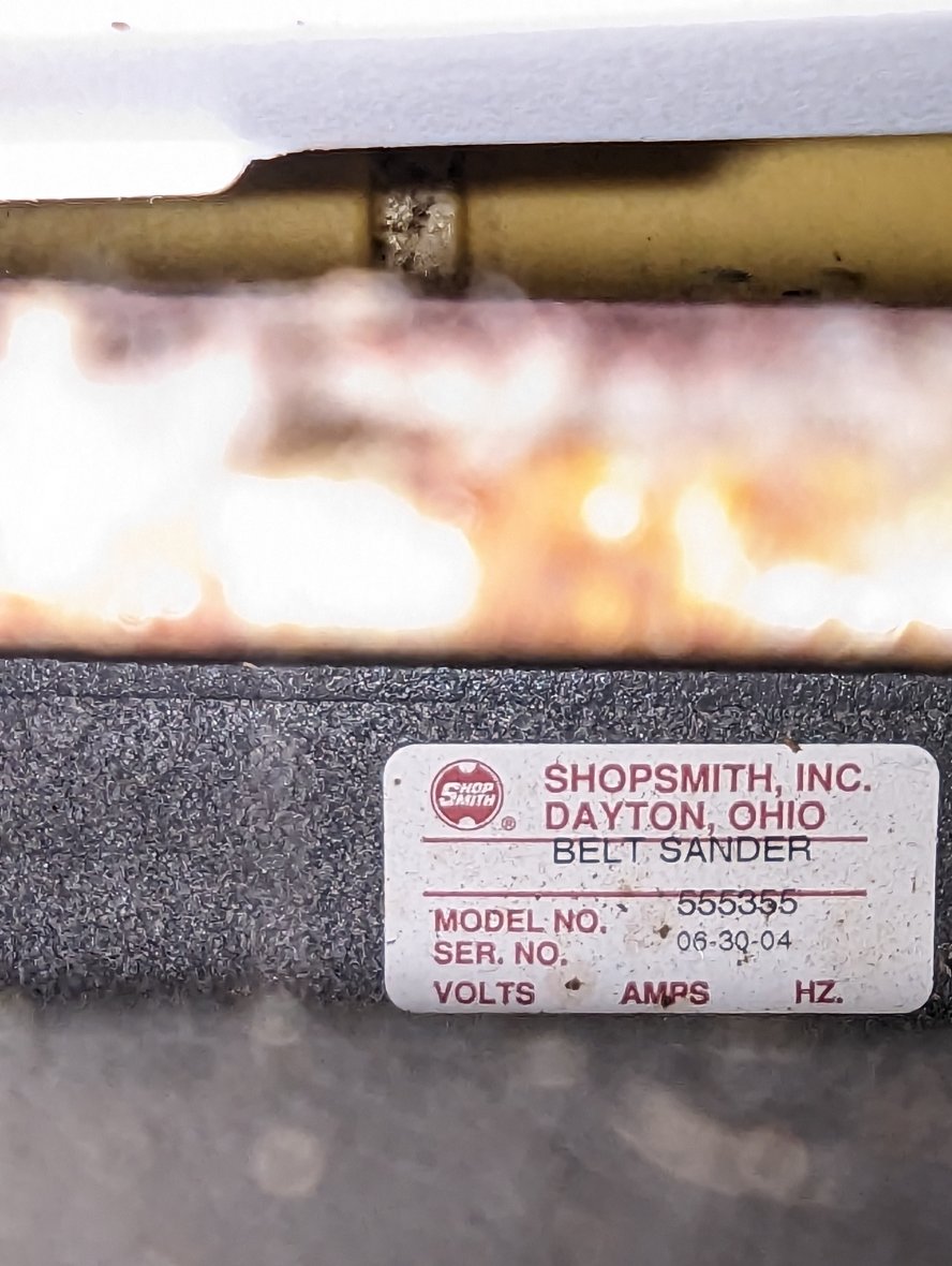

I was able to get a peek under the belt on the belt sander. (Photo attached.) It's also 2004. I agree that it's probably a safe assumption that the Mark V is also from 2004.

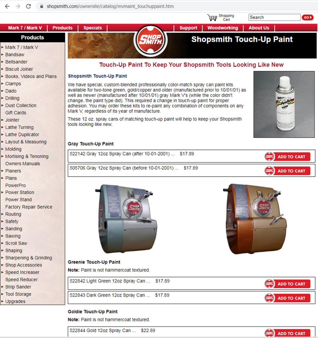

So, that being sorted, is there somewhere that I can buy touchup paint already mixed? Or do I need to get the formula and take it to a hardware store?

In answer to your touch-up paint question, I found this on Shopmith's website:
- touch up paint from website.jpg (223.72 KiB) Viewed 7505 times
