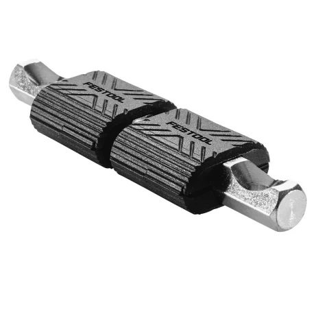

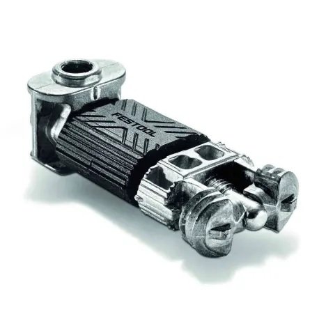

Festool Domino Description (online excerpt):
The Dominos are made out of solid Beech, which are both stamped and compressed. The stamping leaves pockets for glue, and the compressing allows the Domino to swell when exposed to the moisture in glue
A couple of examples of Festool connectors for KD furniture but there are more options:
Hey, I have no problem with what you guys describe here. If it works for you, that is great. I grew up on the New Yankee Workshop so for the longest time I was a biscuit joint devotee. Unfortunately, my DeWalt biscuit jointer left A LOT to be desired. Kinda wished I had looked around and found a better one, but I never did. After this I got into M&T joinery using my Mark V and it worked well, but man it was A LOT of work. Even with a sharp bit & chisel it takes A LOT of effort to hog out mortises (tiring for the hand muscles/tendons). Had I known about Geoff Baker's aftermarket drill press handle that he sells back then, I likely would have jumped for joy, but the Shopsmith drill press handle is so short that you really don't have enough leverage with it for M&T joinery IMHO. Next is the table slipping and flexing during this operation. You guys have solved this by switching to horizontal boring mode and that is smart. I still don't like the fact that I would have to put clamps on the main table behind the fence just to keep it in position...otherwise my fence would slip under demanding mortises. I am sure with enough time and attention I could solve this as you have, but I have the Festool Domino now. As I pointed out previously the main advantage of the Festool Domino is the speed. It is fast, really fast to make joinery and it is a really well thought out platform so everything just works really well. The only negative that I have found with it is the price and that is a BIG one. NOT trying to talk anyone into it. There are lots of joinery options to choose from and many different tool choices and tool configurations to accomplish them. Yes, your M&T method may be a bit slower than me with my Festool Domino, but as long as you are making good quality M&T's and are happy with the result that is all that matters. To answer Ed's question on Festool Domino's, below is an excerpt that I found online regarding them. Note they also sell them in Sipo Mahogany for outdoor applications due to its rot resistance. You can also make your own tenon stock, but these won't be compressed and won't have glue channels. I should point out that EVERY Festool Domino fits snug (on dry fitting), but when I used biscuits I found A LOT of variation biscuit-to-biscuit on how well they fit, which always made me question if the joint was good enough. Bottomline is that Festool Domino's are much higher quality and tighter tolerance than ANY of the biscuits that I ever bought...and I bought A LOT of biscuits over time in the past. Sometimes I would cherry pick biscuits to use only the snug ones out of my inventory. One BIG advantage with the Festool Domino is that they sell an impressive line of knock down fittings that fit them. Very helpful when you want to design furniture that can easily be transported and moved. I haven't bought them yet, but intend to get into them soon. My kids are in college now and I will likely be building some furniture for them soon once they get into their own apartments. Having high quality KD fittings is one big attraction to the Festool Domino system.

Hey RFGuy, I don't begrudge you your Festool Domino tool! I'd love to have one --just don't want to pay for one!
That knockdown hardware does indeed look pretty cool! Any reason you can think of why one who didn't own the Festool Domino couldn't buy the knockdown hardware from Festool and then cut the mortises the old fashioned way I describe with an appropriate-sized drill bit?

Al, I’ve often thought about making a jig for mortising on my Shopsmith in horizontal mode, basically the same process as you describe. But why not use a router bit (preferably upcut spiral) instead if a drill bit? They’re actually designed for cutting sideways, as well as plunging.algale wrote: Tue Jan 10, 2023 6:24 pm Hey RFGuy, I don't begrudge you your Festool Domino tool! I'd love to have one --just don't want to pay for one!
That jig may never happen now, because I bought a new CNC router this year. I built a custom table for it, mostly so that I could add an end-working station for M&T, dovetail, box-joint, etc. joinery. It’s even more expensive than a Domino, but vastly more versatile. As for the other downsides, the learning curve is seriously steep, and it’s not at all suitable for taking to a jobsite.
Anyhoo, my new CNC would be dandy for making mortises for the Festool knock-down hardware, so I’m also very curious about that.
