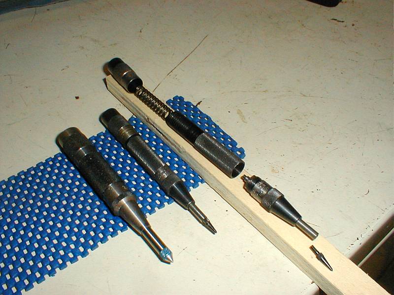

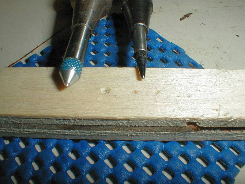

Hi,
Just a couple more things on the auto center punches. I have several of them all the current ones are fine but I got some early editions of a much thinner design which ended up self destructing a part inside... They of course are no longer on the market.
As always here are a couple of pictures. The one on the far left is one that use to have a bunch of different tips for it... they have vanished over time and I have not seen this model anywhere anymore but I liked the wider tip which is the one pictured for wood anyway.
[ATTACH]3664[/ATTACH]
The one in the center and on the right are perhaps the newest I have and came with the replaceable tip. I have a couple that are the same minus the replaceable tip idea. I pulled it apart but not all the way, so if you get one and want to explore be aware that the mechanism that has the release in it also has a spring and if you are not careful you might find yourself on hands and knees searching for it.... not that has ever happened to me but I've heard...
You can see the marks left in the plywood by the punch. Depending on the wood this maybe work for you or it may not. A little practice on a piece of scrap is in order. These do have an impact and look a lot like the tools used to take out safety glass but I wouldn't try that at home. Same issue with some plastics...
[ATTACH]3665[/ATTACH]
Yes they were designed I think for metal work but they do work with wood.
