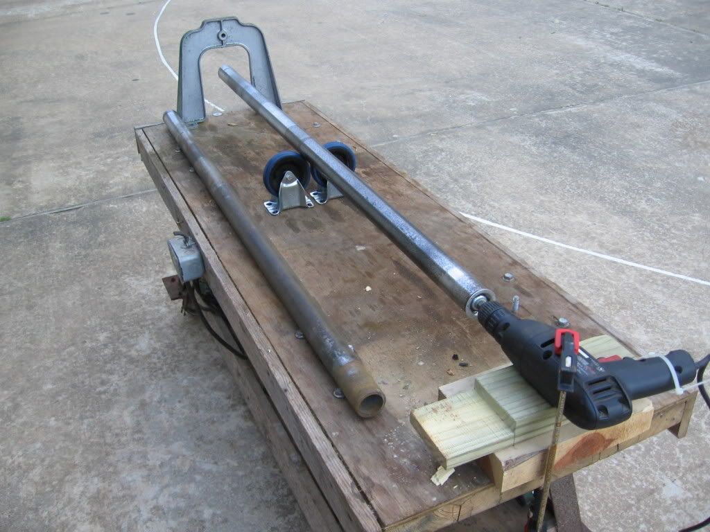

So here is a picture of my "MickyD Lathe(TM)" in action. I used a pair of casters to roll the tube on so heat from friction wouldn't be a problem.mickyd wrote:You would be surprised how many of those pits can be removed if you patiently follow this procedure(or use a lathe if you have one).
Link to Hi-Res

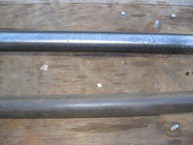

This system worked out great! Here is a closer shot of the two tubes - one about half way through my sanding process, the other waiting its turn.
Link to Hi-Res

heathicus wrote:So here is a picture of my "MickyD Lathe(TM)" in action. I used a pair of casters to roll the tube on so heat from friction wouldn't be a problem.
Well how cool it this setup!!! Excellent job with using those casters. That is a great way to keep the friction down. I LOVE IT!! I am going to link out to your post from my other thread. People have to see this setup. Great improvement.
You need to edit your links to the high res photos. There is some extra code hanging out on the end of the link that prevents them from working. I'll tell you more if you can't figure it out but I think you'll notice when you look at them.

Maybe he got hold of a tail stock casting from a pre release 530!:Ddusty wrote:What was the safety guard before it became the safety guard. Very innovative devices you folks have developed.
I guess it's hard to tell from the pictures, but the casters are screwed down to the bench surface.mickyd wrote:Hey heathicus, did you use this beast with the casters free standing or did you eventually mount them?
That bench was part of the ER I bought that I'm restoring and I'm using it as a work surface. It's in rough shape, and I plan on rebuilding it after the ER is completed.
That explains the switch.heathicus wrote:I guess it's hard to tell from the pictures, but the casters are screwed down to the bench surface.
