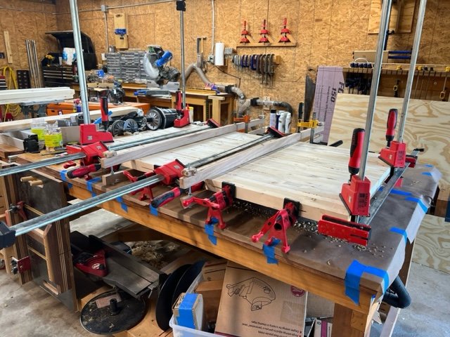

I've been away from this project for a bit, but now I am back on it. I decided the two table tops I made were too thin and not wide enough (at 39 3/4".)
I am currently doing the glue up of the second set. They are about 1 1/2" by 44". I had been having problems with my Bosch router on the last set, and it turned out to be the speed control. I got that fixed and cut out the first top. I wasn't overly pleased with the top itself, as it required a good deal of hand planing to flatten it. My glue game needs work....

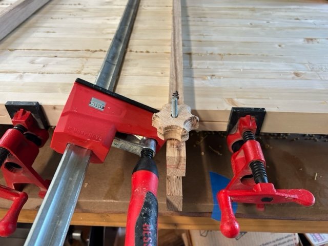

For the second one, I decided to make a pair of clamping cauls. Also, using 5 biscuits per joint. Making these two changes has greatly improved things.

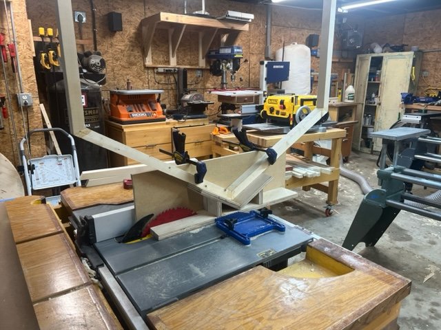

I have the frame of the octagon built and today I added splines to the joints to strengthen them. Had to make a 30 degree jig for that. I wanted to cut them on my SS, but I had a height concern and ended up using my Dewalt job site saw. The splines are glued up and tomorrow I will trim them.
The octagon is based on a 46" circle, so it will extend one inch past the rest of the assembly. I thought that would be a good compromise between stability and the trip hazard of extending the base too far.

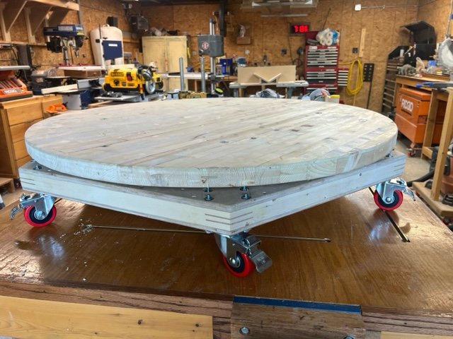

This weekend I got the HEXAGON torsion box built, test mounted casters and test mounted the bottom table, base and Lazy Susan hardware.
I drilled the holes for mounting slightly oversized to allow a bit of adjustment as needed. So far I am satisfied with the way it spins.
