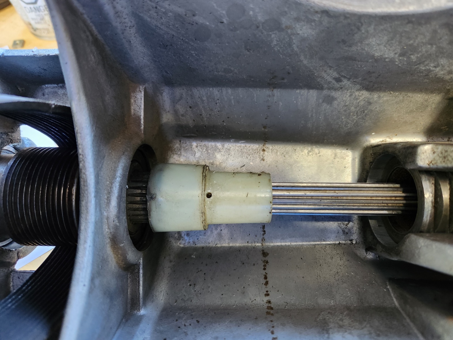

Do you think drilling a couple of small holes in the plastic spline receiver would significantly weaken it? Is it a Mark V part that I can replace?
Re: Mark VII “Project Machine”
I think one small hole(<1/16") will prove the theory and not diminish strength. I believe compatible with all other versions of the nylon coupler.

That’s a relief. Today I’m going to try the quill return without the main shaft in place to make sure it isn’t friction in the sliding area of the quill. If it isn’t that I’ll try a small hole and see if that helps. I’ll also try some dry lube spray.

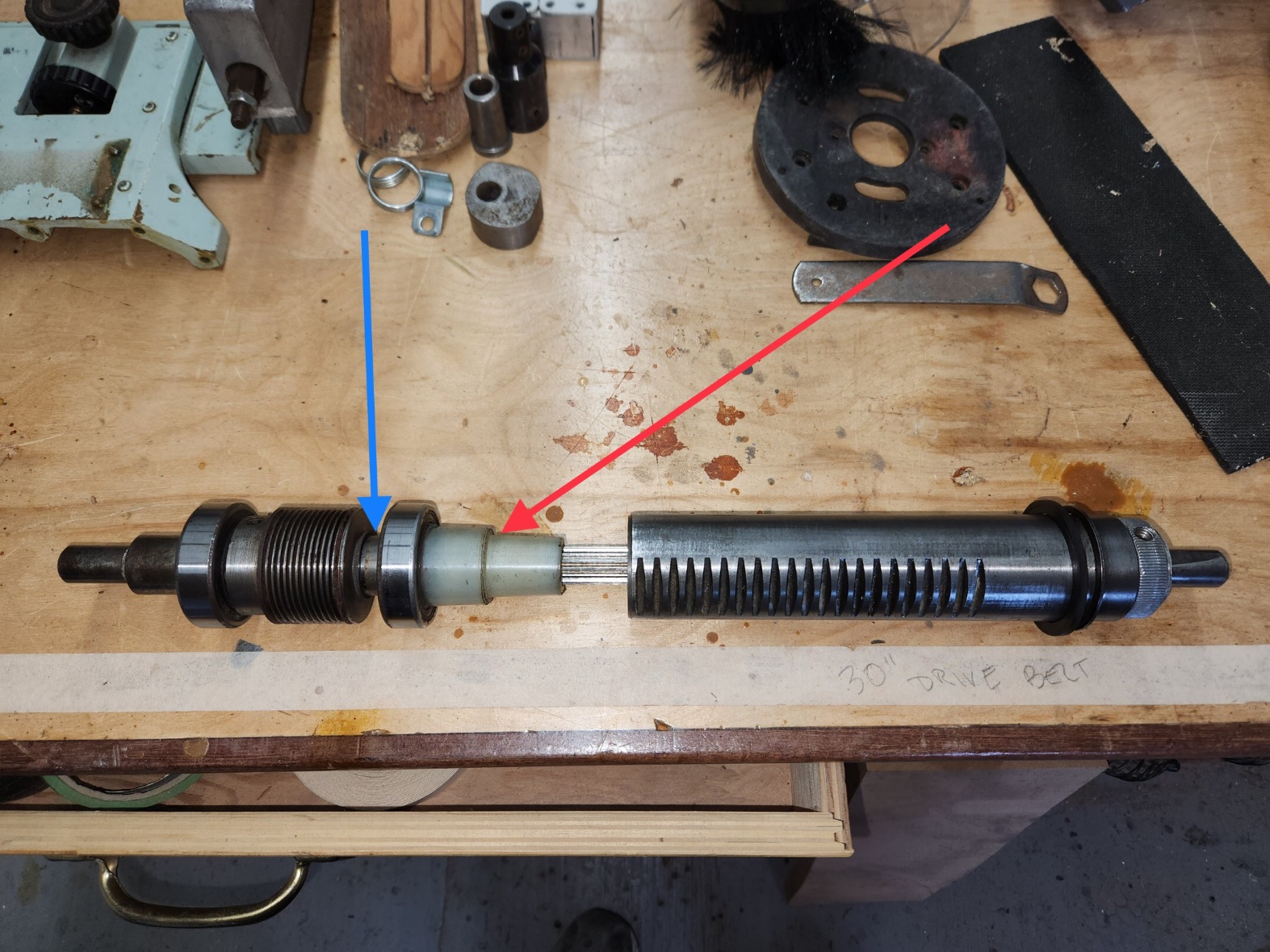

I’m thinking about the red arrow for the first try. What do you think of trying where the blue arrow is?
Blue, no. If it is the coupler that is creating the 'vacuum' the red location is more likely to succeed. That is as long as it coincides with the transition between quill spline and drive sleeve spline.
How some ever, the trapped air is likely in the drive sleeve. But the splines should allow air to escape.
I think we need to be sure just where the trapped air is.
But like you said it may be spline drag.

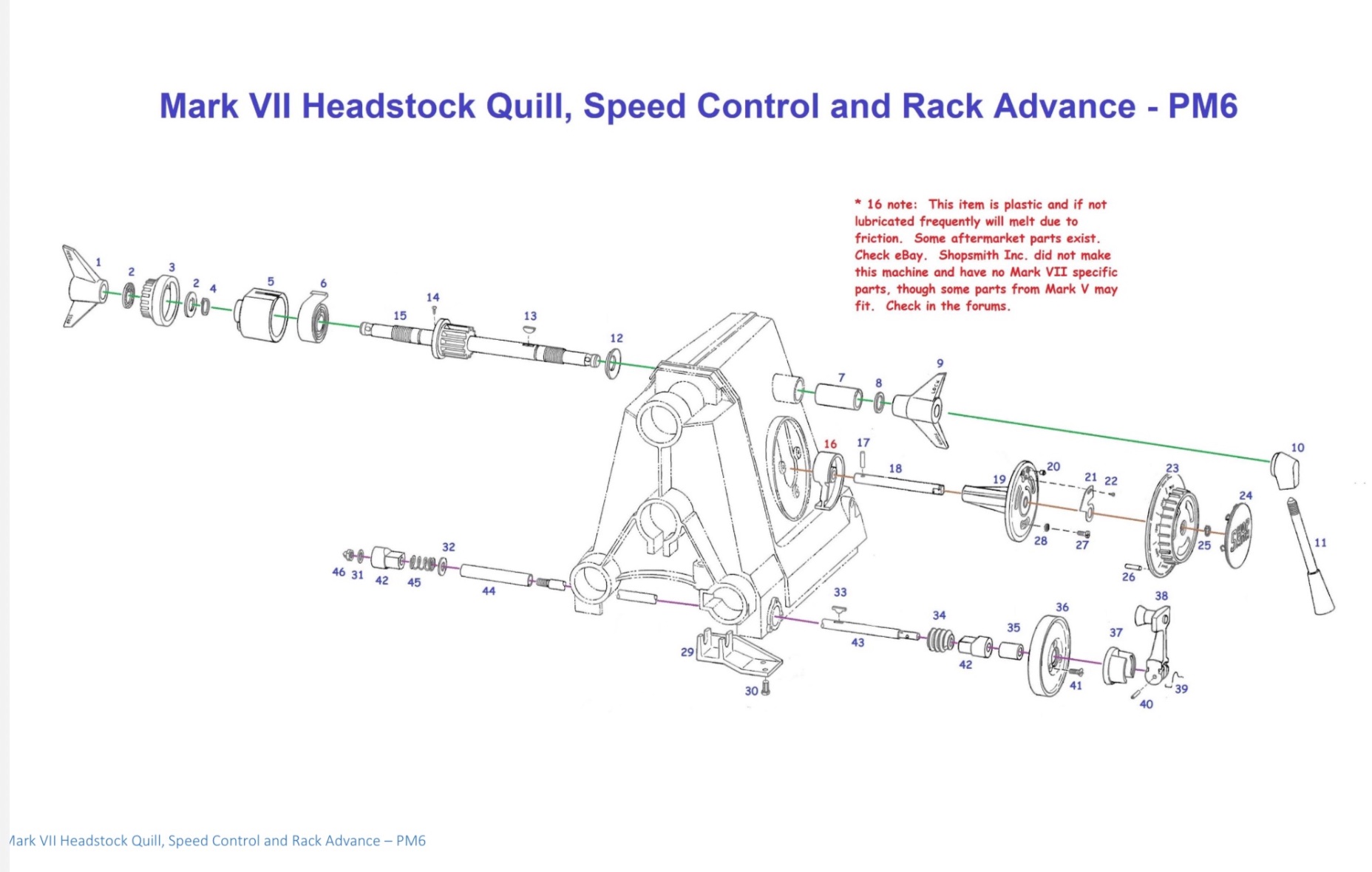

I cleaned a dry lubed everything and drilled one 7/64” hole in the coupler. I also flipped the cupped washer in the quill feed. (The diagram in the manual disagrees with you about that) it moved a little better but still did not retract well. I decided to move on and finally got it running. With the vibration of the motor running, or the rotation of the shafts perhaps, it retracted just fine. I didn’t get much time to play with it as it was the end of the day but tomorrow I should be able to clean up the details and have a better picture of what I have.
Yes I was influenced by the M5 positioning of the cup washer. Thank You for catching that! That shifts the quill shaft out towards the stop end.
I do question it's accuracy as the cupped washer provides the transition between the sliding sleeve and the web.
mvii quill.jpg (104.81 KiB) Viewed 1236 times
Gotta say 'my way' makes more sense.
