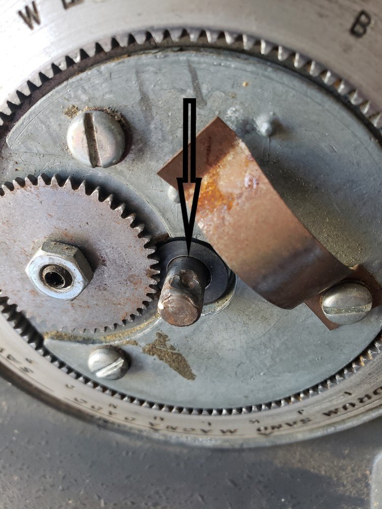

This is what that flat spring looks like in position as shown in the picture below. It is the part under the arrow not what the arrow is pointing to. Sorry it's the only picture I could find of it right now.
_
speed control - arrow.jpg (150.64 KiB) Viewed 1694 times
