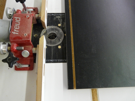

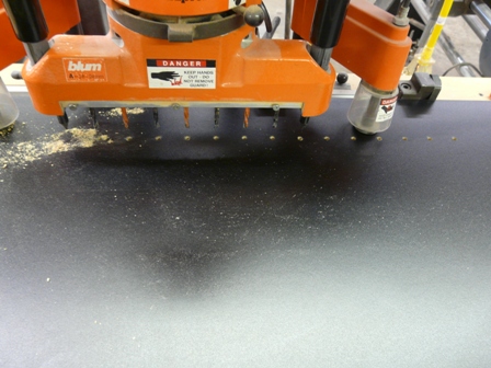

Working on the glass front cases
[ATTACH]4491[/ATTACH]

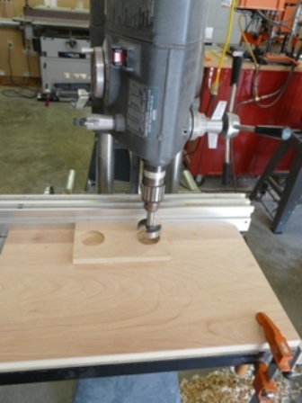

Routing a groove for the tempered glass front.
[ATTACH]4492[/ATTACH]
[ATTACH]4493[/ATTACH]

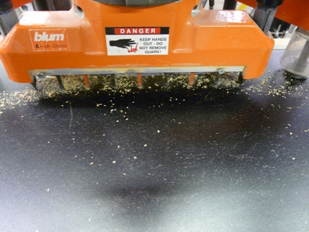

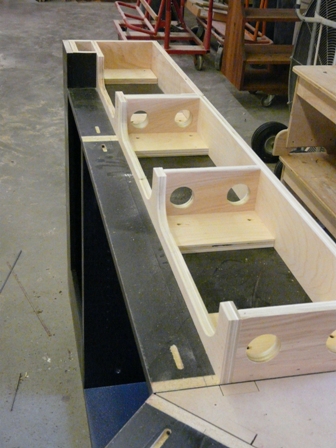

Line boring the cabinet ends on the mini press.
[ATTACH]4494[/ATTACH]
Cabinet being assembled with biscuits and pocket screws.
[ATTACH]4495[/ATTACH]
Cardboard template for the tempered glass.
Later we will install some sliding mirror doors on the back side of these cases. The mirror and glass were ordered today.

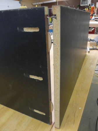

I have had other things going on like job quotes and new Shopsmith toys
, but the cabinets are going together slowly. I have started to temporarily assemble them as they are laminated. They are upside down because the toe kick or base area has to have a wire chase built in. We will get to that next week.

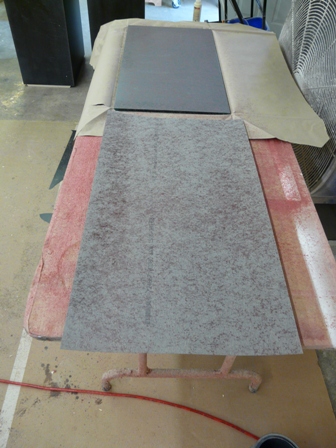

[ATTACH]4527[/ATTACH]
[ATTACH]4528[/ATTACH]
Man that black laminate shows all the dust!
Mark

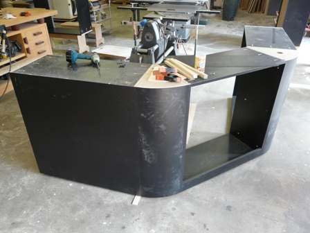

- Posts: 1627
- Location: Greer SC
Toe kick wire chase

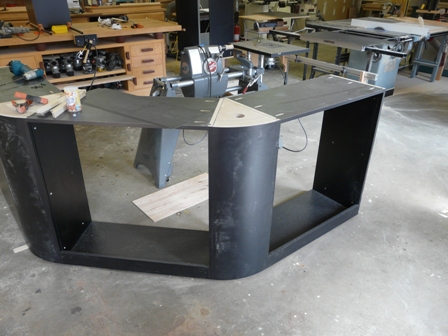

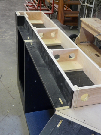

The cabinets are all laminated and in place. Work has begun on the toe kick/wire chase.
[ATTACH]4581[/ATTACH]
Drilling gussets
[ATTACH]4582[/ATTACH]
Notching for electrician's access
[ATTACH]4583[/ATTACH]

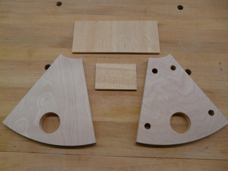

Parts for toe kick for the pie shaped fillers
[ATTACH]4584[/ATTACH]
Toe kick in place with out finished board
[ATTACH]4585[/ATTACH]
These finished boards will be screwed in place after all electrical work is done.
Mark

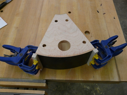

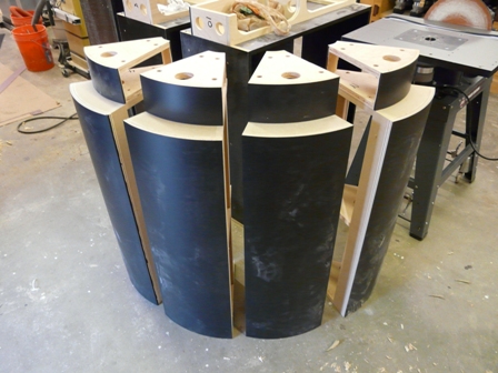

Sorry for the lag time between post but I have been busy. I have dissembled the set up to finish the laminating.
[ATTACH]4598[/ATTACH]
This is one of the bases for the fillers
[ATTACH]4599[/ATTACH]
Bases attached.
Mark
Bases attached.
Mark

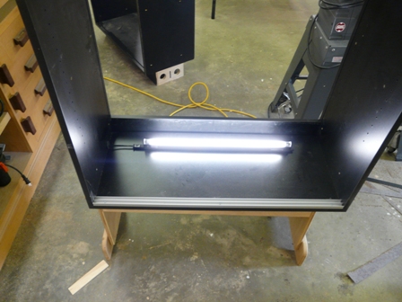

The next step is to prep the cabinets for lights. I will temporally install one to check fit. Much of the finish work will be done on the job sight. I have cleaned all glue over spray in the shop, but will have to clean all laminate and glass of dust and smears as it is installed. Any cleaning in that area done in the shop is wasted time.
[ATTACH]4600[/ATTACH]
Light temporally installed. Notice the top track for siding doors.
[ATTACH]4601[/ATTACH]

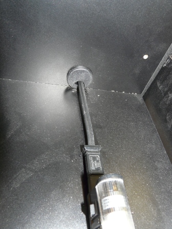

Grommet for wire.

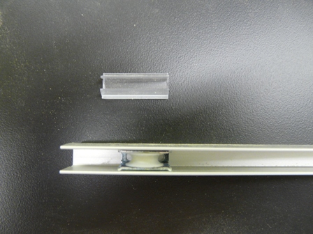

[ATTACH]4602[/ATTACH]
Laminating the back side of the mirror doors.
[ATTACH]4603[/ATTACH]

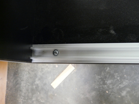

Bottom track for sliding doors.
[ATTACH]4604[/ATTACH]
Bottom shoe with rollers for the bottom of doors and plastic glides for the top.
Mark

Grommet for wire.

- Posts: 1627

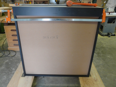

Sliding doors in place
[ATTACH]4605[/ATTACH]
This is the back side of the doors with laminated surface.
- P1010141.jpg (112.77 KiB) Viewed 3081 times

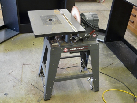

What equipment I have, I have had for many years and yet I never cease to learn new ways to put it to use.mbcabinetmaker wrote:[ATTACH]4605[/ATTACH]
I just spotted your router table mounted on a power station for the base. This will be ideal for those weekends when I'm asked "Why don't you come over for a back yard barbecue and oh ya bring your wood working equipment".
Again, this thread has been very informative. I very much appreciate all that you have presented here. Both projects have been very enlightening. Thank you.

Good Eye Dusty! I noticed it but did NOT recognize it as a POWER STATION!dusty wrote:What equipment I have, I have had for many years and yet I never cease to learn new ways to put it to use.
Ditto EVERYTHING Dusty said above!

Now I gotta spend for a replacement miter track. I cannibalized the router table of its miter track to build my outfeed table. Now I gotta put it back and I can not give up the one on the outfeed table.mbcabinetmaker wrote:Dusty
I call it my power/router/sander. I had to cut 6 inches off of the mounting tubes to get it close to the sanding disc but it still works fine on the SS.
[ATTACH]4607[/ATTACH]
It is a very handy tool!:)
