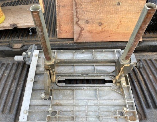

Okay next I am going to work on the table.
It's the worst of all the tables I have.
Although it's not That bad.
I Been searching this forum and I have seen before and after pictures of a Member on this forum using CitriStrip. :D
I have some on the way to start refurbishing this table.

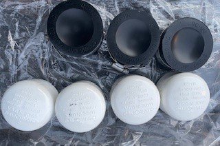

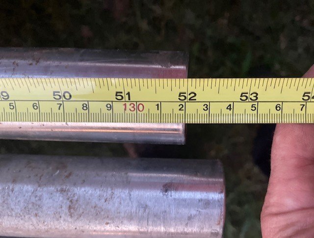

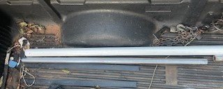

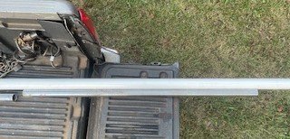

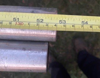

I made some PVC tubes to soak the way and support tubes in Evaporust.
I bought two 10' sticks of the PVC
It was enough to make 4 tubes and the 2 short pieces I capped off for the drip dry of the Evaporust when I remove them from the tubes.
I made my tubes 55" long.
I bought these caps at my local plumbing supply place.
I marked the tubes so I would know which one was which.
I plan to put the way tubes in the lathe and straight them.
I set the on the granite table at work and they are bent ever so slightly

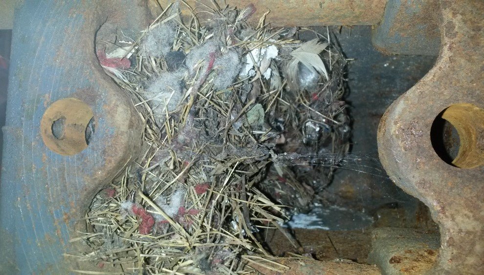

You never know what might be living inside a Shopsmith tool that has been stored for a time. Below is the Headstock from one of the Model 10ER's I have restored.
_
R57376 HS int pre.jpg (178.29 KiB) Viewed 728 times
I was glad that "squatter" was gone when I bought this "barn" find.

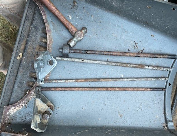

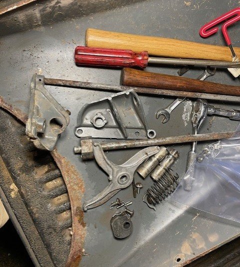

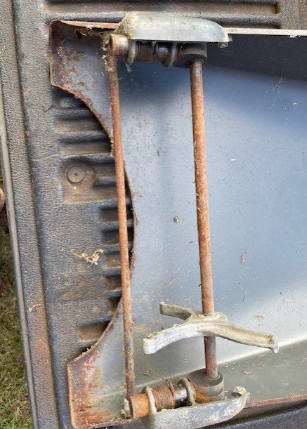

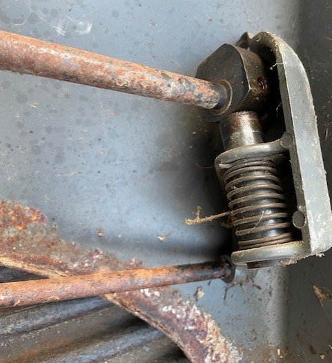

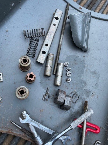

I see you have started taking the Retractable Caster sets apart. Putting them back together is not as easy as putting a part back in place where one of the same parts was originally located. Below is a link to Yet another "Goldie" Restoration and beginning on page 9 and continuing on page 10 is a discussion on disassembling and reassembling the Retractable Casters.
viewtopic.php?t=35396&start=80
The Retractable Castor sets have (when mounted on the legs) a right and a left set. The one is a mirror image of the other. What makes up each side is a Right-side Bracket and a Left-side Bracket. The Tie Rod keeps them together along with being mounted to the Bench Assembly. The holes drilled for the Roll Pins may be drilled slightly off from one to another. The same is true for Roll Pins that hold the Cams and Foot Pedal to the Drive Rod. Reassembling these parts in different positions than they were originally can have the assembled Retractable Caster Assembly out of alignment. The Plungers, Springs, Retaining Clips, Castors and mounting hardware are not position specific.

Thanks for the Link I will check it out. :)
I have done a lot of Reading on this forum. :D
There was one Thread that suggested to put center puch marks on them.
So that what I done and I keep the 2 sides seperated.
I will be looking at that thread for a Refresher course for sure. ;)

Posts: 35441
Re: Restoration of Mark V / produced on 11/84
Very good move(s)!!!

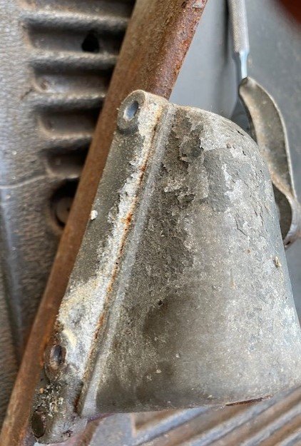

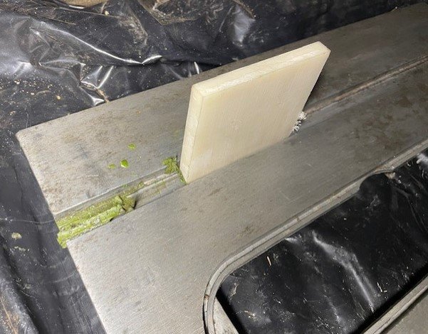

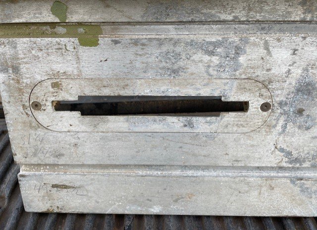

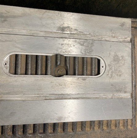

Okay I jumped in with the Orange Strip stuff.
Citrus strip//That Orange stuff. :D
It worked pretty well.

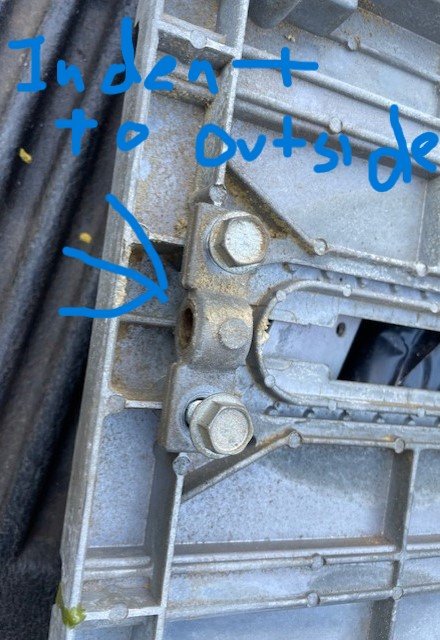

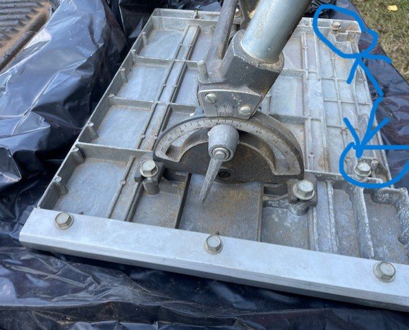

Before disassembly picture

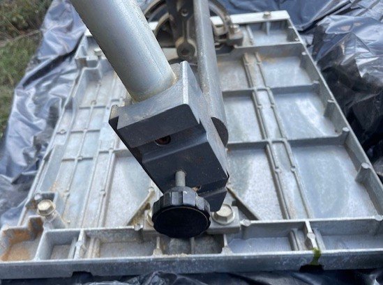

What are these 2 Bolts Circled for?
They had a gap and was just somewhat tight.

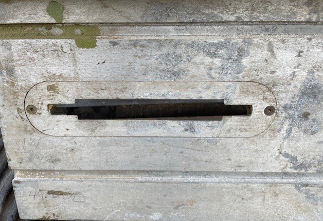

Before picture for / Me / Everyone. ;)
I know I need to read to Manual in More Detail :rolleyes:

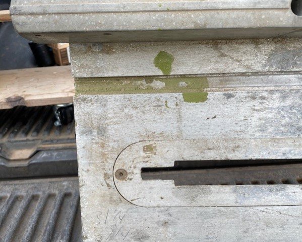

What are these dovetail grooves for below this Knob?
attachment=5]sst3.jpg[/attachment]

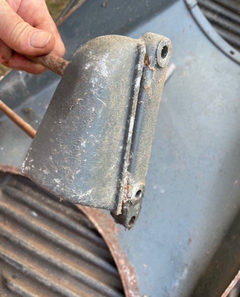

This is reminder for (Me) the position of this bracket.

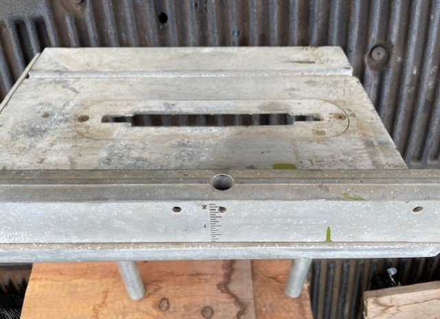

Working on it. :)
Then Here We Go. :D

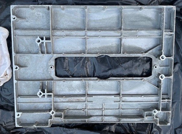

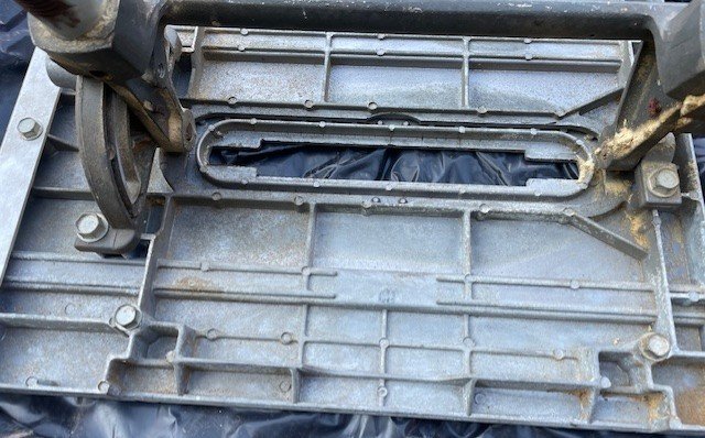

First cleaning .
Comparison with plate that was not cleaned. :cool:
