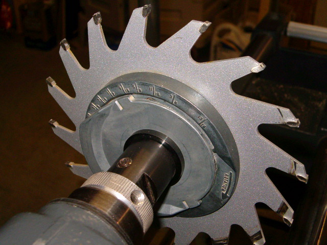

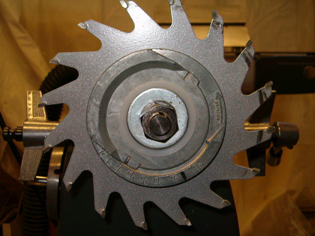

This is the adjustable dado that I use.
[ATTACH]4621[/ATTACH]
Is this the correct arbor to be used with the dado blade?
[ATTACH]4622[/ATTACH]
Yes! Looks like a SS 505506.

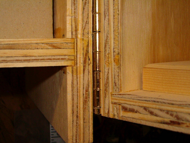

The first two photos show fitting plywood. These pix weren't meant to illustrate joinery. You'll have to enlarge them. I can take a close up.......

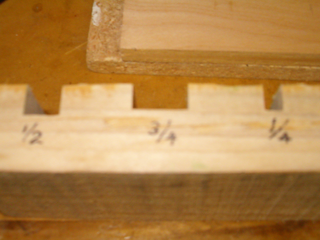

Hang on, I'll take some more photos. The blade I use yields very flat bottoms of dados when set at around 3/4". There are slight irregularities when dialing down to 1/4" (a slop toward one side) and dialing up to larger (a raised center) Anyway I'll attempt to get more pix. I don't believe my dados have anything to do with craftsmanship - I just take them as they come. (more photos)

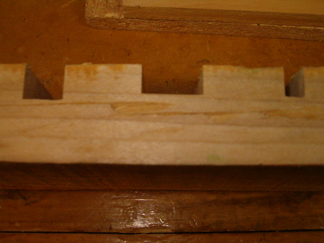

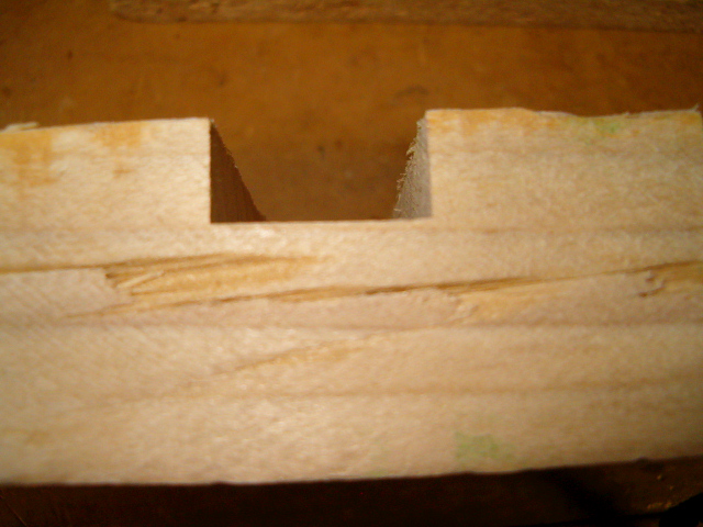

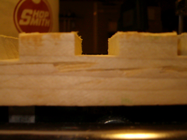

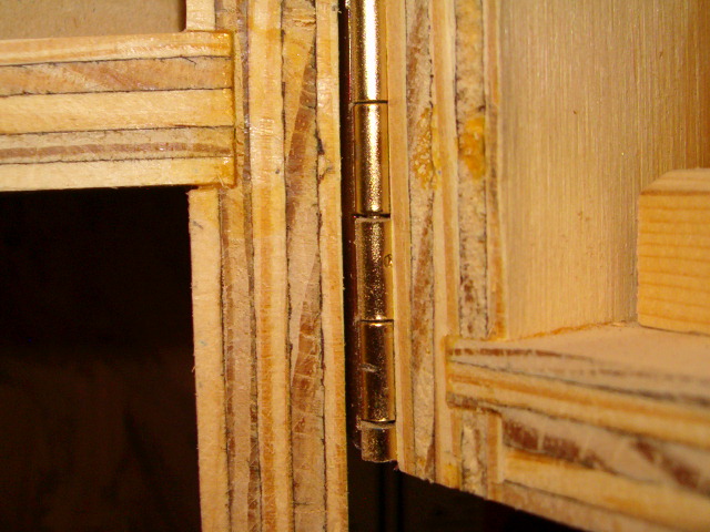

One of the things I love about my wobble is the speed it will adjust to different widths. Even fractions of widths to conform to plywood. It too just 45 minutes to go to the shop, snap 13 photos, set up the dado in the machine, adjust to 3 widths, cut them and get back to the computer.
Here are the photos:
[ATTACH]4623[/ATTACH]
[ATTACH]4624[/ATTACH]
[ATTACH]4625[/ATTACH]
[ATTACH]4626[/ATTACH]
[ATTACH]4627[/ATTACH]

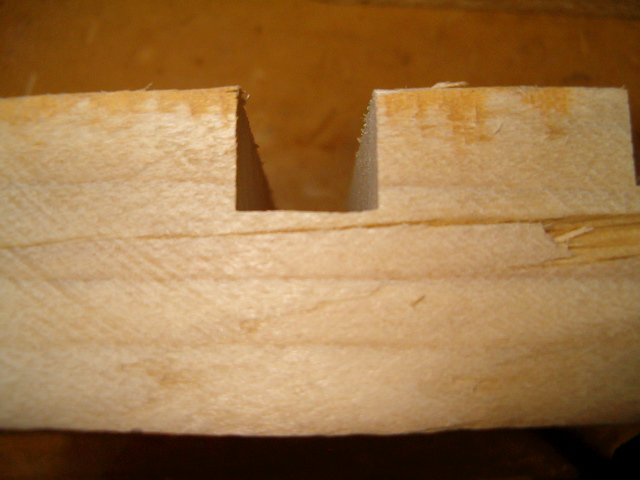

Rather than display all of the photos, I'll just show those showing the shape of the various dados. Notice that the 1/2" dado show a slightly sloped bottom from left to right, but the amount of slope is not great. The 1/2" dado is the second photo.
Yes, I grbbed a piece of scrap wood. You'll notice the split (check) through the piece.
