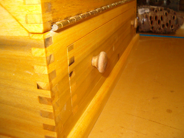

First there's the BOX JOINT. This is a strong joint that interlocks somewhat like dovetails.
[ATTACH]7325[/ATTACH]

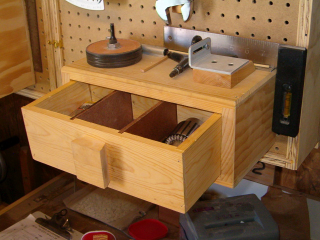

There is a rabit joint that also can be reinforced with screws, dowels, splines nails or staples. Both the drawer box and drawer have rabet joints:
[ATTACH]7356[/ATTACH]

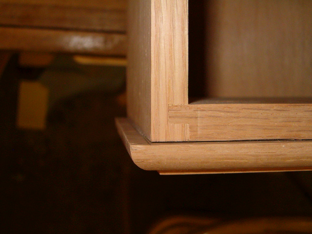

There is a single or double dado joint.
Single - If you think of this joint without the false drawer front - you would have a good box joint!
[ATTACH]7329[/ATTACH]

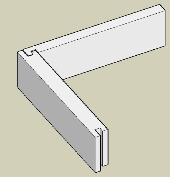

Double dado -
[ATTACH]7324[/ATTACH]
