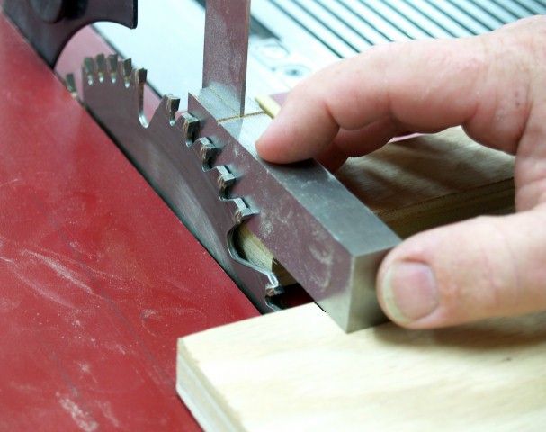

This is how we teach it at the Academy:
[ATTACH]273[/ATTACH]
Mark the wood and place it on your sled or against the face of the miter gauge. Flip the saw guard up out of the way and hold the flat surface of the base of an Engineer's Square against the side of the blade you want to align with the cut mark. The square should contact at least three teeth on the saw blade. It helps to put a scrap the same thickness as the workpiece beside the blade and rest the base of the square on it.

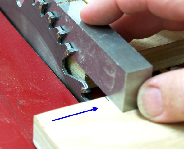

[ATTACH]274[/ATTACH]
Move the workpiece sideways until the cut mark aligns with the surface of the square. Remove the square and the scrap; swing the guard down into place, and make the cut.

Nick wrote:This is how we teach it at the Academy:
Good one Nick! Thanks!! :D This goes in the category of]"Why didn't I think of that!"[/B]
Will save drawing on my table!
