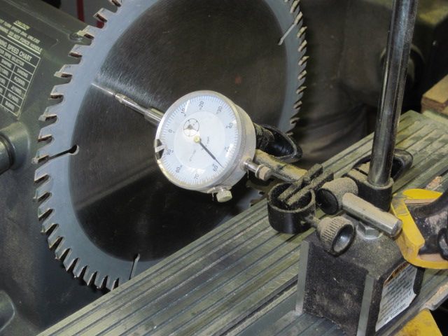

Big Sky, I measured runout on two saw blades mounted on two different arbors and got readings similar to yours -- .007 and .008. I would have hoped for better, but that's what it is. These were saw blades with 1 1/4" arbor holes.
Here was my set-up:
[ATTACH]12818[/ATTACH]
Here was my set-up:
- Runout.JPG (118.72 KiB) Viewed 1686 times
