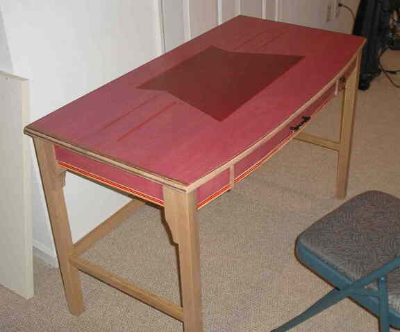

Just for some comic relief.... I find I can mentally manage my wood projects OK... until the finish steps!
Here is a desk I did this past winter (I'm using it right now). It was *supposed* to have a uniform light red glaze on the top. Actually I made an oak desk, put pickling white stain all over it, sealed it once with poly, then added a red glaze to the top and side pieces. So far so good... until I added my final poly-coating. My brush lifted off big patches of red glaze! I almost kicked the thing into splinters. But then I just got some darker red paint and added a graphic on the top, and finally polyurethaned it for the last time. When I was done, my buddy pointed out that I had recreated a "Pizza Hut" emblem. Now I just cover the desk with a bunch of junk.

THANKS!!!!! I needed that. I'm so frustrated, so discouraged.
