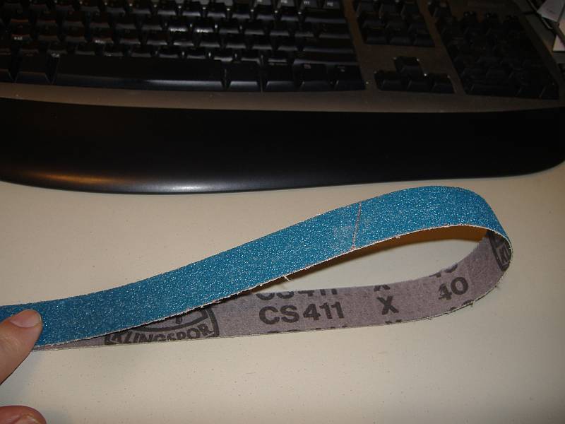

Several companies have been peddling this material for a while now, 3M, Norton and others. They are sometimes referred to as planer belts. Some are made from Alumina Zirconia. They have them for belt sanders and smaller diameter disk sanders as well as 1"x42 belts.

Several companies have been peddling this material for a while now, 3M, Norton and others. They are sometimes referred to as planer belts. Some are made from Alumina Zirconia. They have them for belt sanders and smaller diameter disk sanders as well as 1"x42 belts like this.
[ATTACH]8177[/ATTACH]
Now from what I see they did not mention what ceramic is being used or whos' but the color reminds me of I think 3M I'd have to check to be sure, they also use green for some automotive sanding products....
Now it could be I'm wrong but the description sure fits as do the results... the belt pictured above looks new, it is not, I've had it a couple of years and have used it a few time.
